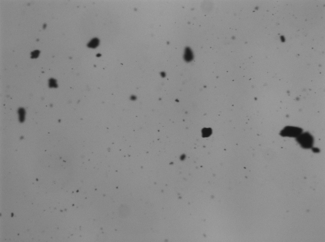

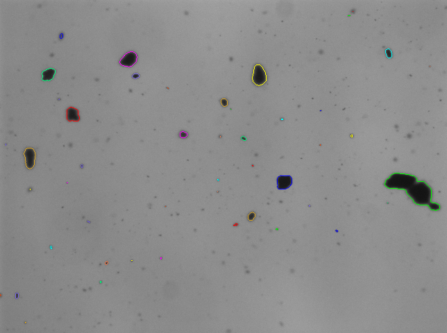

djx808 发表于 2018-8-30 09:17:14 | 显示全部楼层
  1. read_image (Image163043lxe70eewbboxzuo9, 'C:/Users/user.bm-t460p-05/Desktop/163043lxe70eewbboxzuo9.bmp')
  2. get_image_size (Image163043lxe70eewbboxzuo9, Width, Height)
  3. binary_threshold (Image163043lxe70eewbboxzuo9, Region, 'max_separability', 'dark', UsedThreshold)
  4. threshold_sub_pix (Image163043lxe70eewbboxzuo9, Border, UsedThreshold)
  5. length_xld (Border, Length1)
以上是算子,效果图在下面
效果图
效果图
