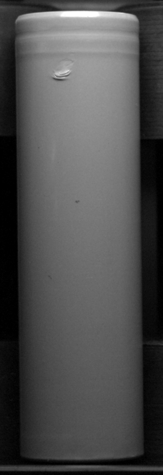

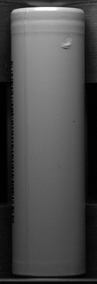

请教各位大神,这4个图片上电池表面的缺陷怎么检测出来呀?初学者想学习学习,哪位大神做出来了能分享下代码吗?十分感谢

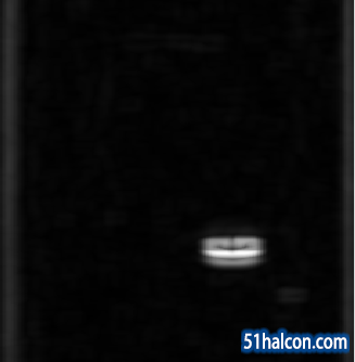

Criss 发表于 2019-8-6 14:36:37 | 显示全部楼层
  1. dev_close_window ()
  2. read_image(Image,'C:/Users/Criss/Desktop/132614b55l1gfhho55fn1n.bmp')
  3. get_image_size(Image,Width,Height)
  4. dev_open_window (0, 0, Width, Height, 'black', WindowHandle)
  5. set_display_font (WindowHandle, 16, 'mono', 'true', 'false')
  6. dev_set_draw ('margin')
  7. dev_set_line_width (3)
  8. dev_set_color ('red')
  9. dev_display (Image)
  10. draw_rectangle1 (WindowHandle, Row1, Column1, Row2, Column2)
  11. gen_rectangle1 (Rectangle, Row1, Column1, Row2, Column2)
  12. reduce_domain (Image, Rectangle, ImageReduced)
  13. crop_domain (ImageReduced, ImagePart)
  14. get_image_size(ImagePart,Width,Height)
  15. optimize_rft_speed (Width,Height, 'standard')
  16. Sigma1 := 10.0
  17. Sigma2 := 3.0
  18. gen_gauss_filter(GaussFilter1,Sigma1,Sigma1,0.0,'none','rft',Width,Height)
  19. gen_gauss_filter(GaussFilter2,Sigma2,Sigma2,0.0,'none','rft',Width,Height)
  20. sub_image(GaussFilter1,GaussFilter2,Filter,1,0)
  21. *
  22. read_image(Image,'C:/Users/Criss/Desktop/132614b55l1gfhho55fn1n.bmp')
  23. rgb1_to_gray(Image,Image)
  24. reduce_domain (Image, Rectangle, ImageReduced)
  25. crop_domain (ImageReduced, ImagePart)
  26. rft_generic(ImagePart,ImageFFT,'to_freq','none','complex',Width)
  27. convol_fft(ImageFFT,Filter,ImageConvol)
  28. rft_generic(ImageConvol,ImageFiltered,'from_freq','n','real',Width)
  29. gray_range_rect(ImageFiltered,ImageResult,10,10)
剩下只需要根据阈值进行分割提取这个区域即可!

大神呀,你检测的哪张图片啊?我的4张图片想实现同时检测的
Criss 发表于 2019-8-6 16:00:23 | 显示全部楼层
最后一张,上面的代码在*后面的用for循环就可以了!
