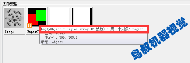

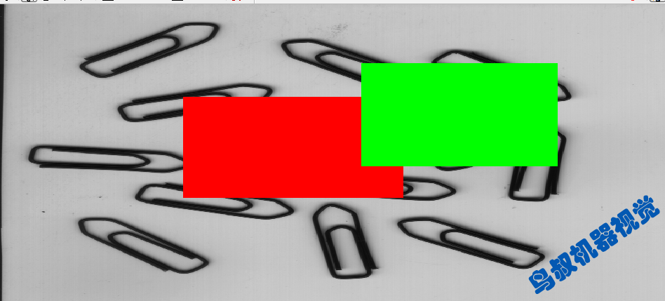

Criss 发表于 2016-7-17 23:16:13 | 显示全部楼层
  1. read_image (Image, 'clip')
  2. gen_empty_obj (EmptyObject)
  3. draw_rectangle1 (3600, Row1, Column1, Row2, Column2)
  4. gen_rectangle1 (Rectangle1, Row1, Column1, Row2, Column2)
  5. concat_obj (EmptyObject, Rectangle1, EmptyObject)
  6. draw_rectangle1 (3600, Row1, Column1, Row2, Column2)
  7. gen_rectangle1 (Rectangle2, Row1, Column1, Row2, Column2)
  8. concat_obj (EmptyObject, Rectangle2, EmptyObject)
  9. dev_display (EmptyObject)
