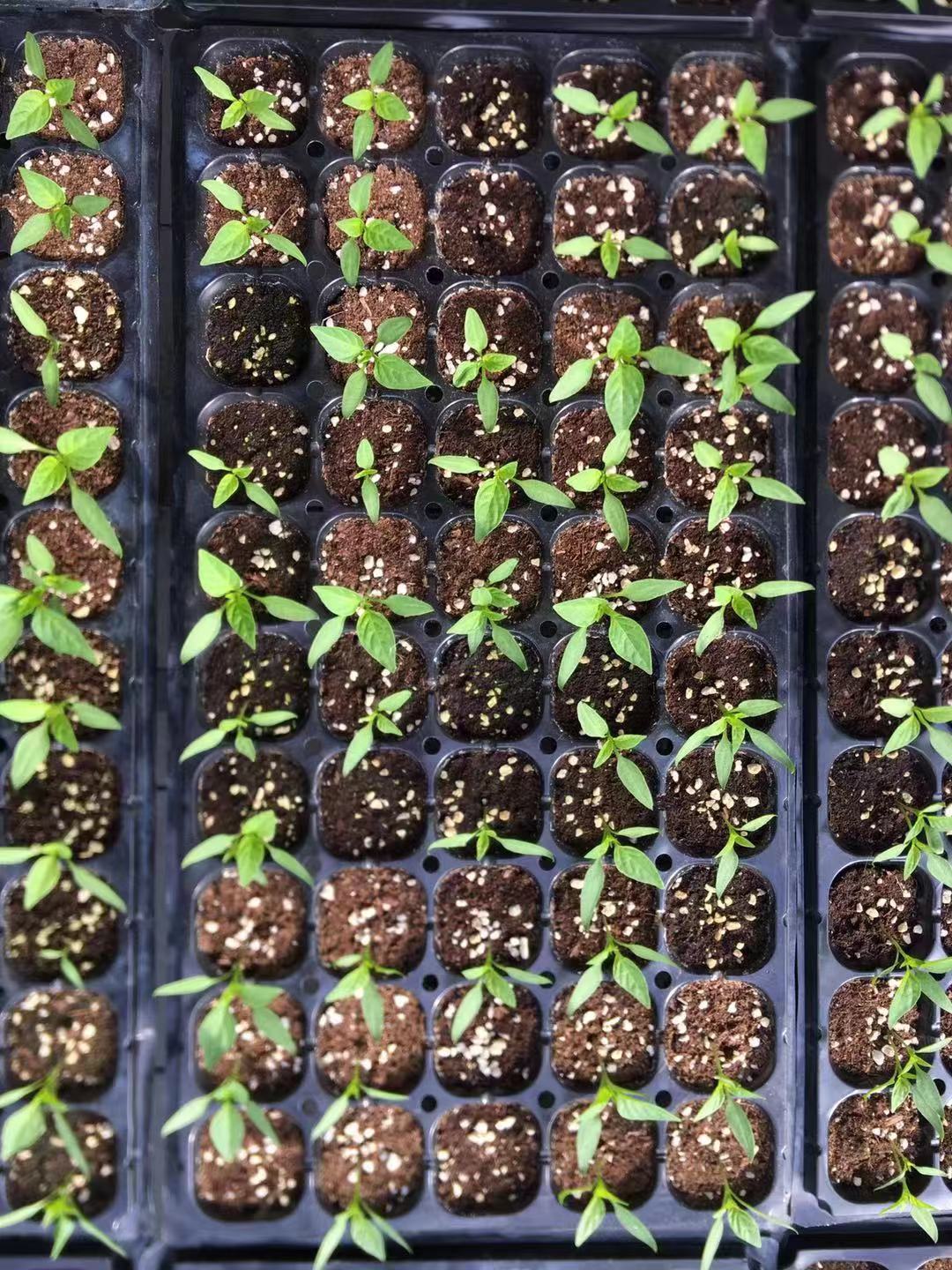

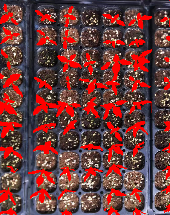

想学好视觉 发表于 2023-9-13 21:18:16 | 显示全部楼层 |阅读模式
求助,把苗识别出来之后,请问有没有一种什么方法,把这个放苗的一个个方格划分出来,然后判别这个苗在哪个方格里,有些方格没有苗就判为空,有些方格的苗超出去了,但大面积还在之前的方格里,就把超出去的苗无视掉

freekun139com 发表于 2023-9-14 13:50:38 | 显示全部楼层
是否可以拿空的托盘作模板,从而分割出方格
再根据方格模板在有苗的图像上分割出方格进行分析

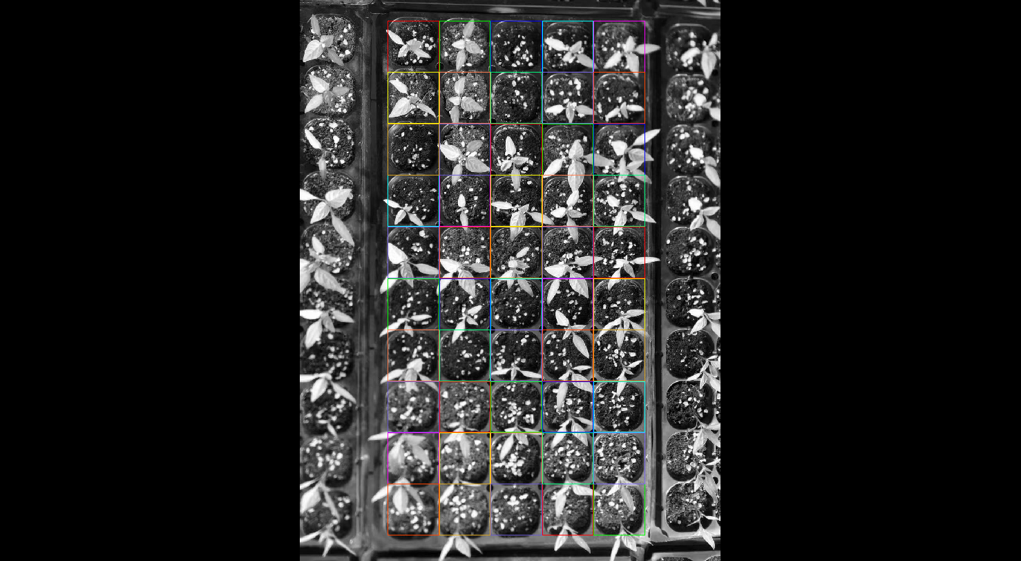

freekun139com 发表于 2023-9-14 14:31:05 | 显示全部楼层
  1. read_image (Image, '210923alfvkjbkq7kfh7vv.png')
  2. decompose3 (Image, ImageR, ImageG, ImageB)
  3. gen_rectangle1 (ROI_0, 653.946, 441.468, 910.38, 690.718)
  4. reduce_domain (ImageG, ROI_0, ImageReduced)
  5. threshold (ImageReduced, Region, 0, 50)
  6. opening_circle (Region, RegionOpening, 3.5)
  7. closing_circle (RegionOpening, RegionClosing, 3.5)
  8. connection (RegionClosing, ConnectedRegions)
  9. select_shape (ConnectedRegions, SelectedRegions, ['circularity','width'], 'and', [0.85,15], [1,25])
  10. gen_contour_region_xld (SelectedRegions, Contours, 'border')
  11. fit_circle_contour_xld (Contours, 'algebraic', -1, 0, 0, 3, 2, Row, Column, Radius, StartPhi, EndPhi, PointOrder)
  12. gen_circle_contour_xld (ContCircle, Row, Column, Radius, StartPhi, EndPhi, 'positive', 1)
  13. gen_cross_contour_xld (Cross, Row, Column, 16, rad(45))
  14. gen_region_polygon_filled (Region2, Row, Column)
  15. shape_trans (Region2, RegionTrans, 'rectangle1')
  16. smallest_rectangle1 (RegionTrans, Row1, Col1, Row2, Col2)
  17. RowSteps := Row2 - Row1
  18. ColSteps := Col2 - Col1
  19. RowTL := Row1 - 5*RowSteps
  20. ColTL := Col1 - 2*ColSteps
  21. RowBR := Row2 + 4*RowSteps
  22. ColBR := Col2 + 2*ColSteps
  23. gen_rectangle1 (Rectangle, RowTL, ColTL, RowBR, ColBR)
  24. partition_rectangle (Rectangle, Partitioned, ColSteps, RowSteps)
