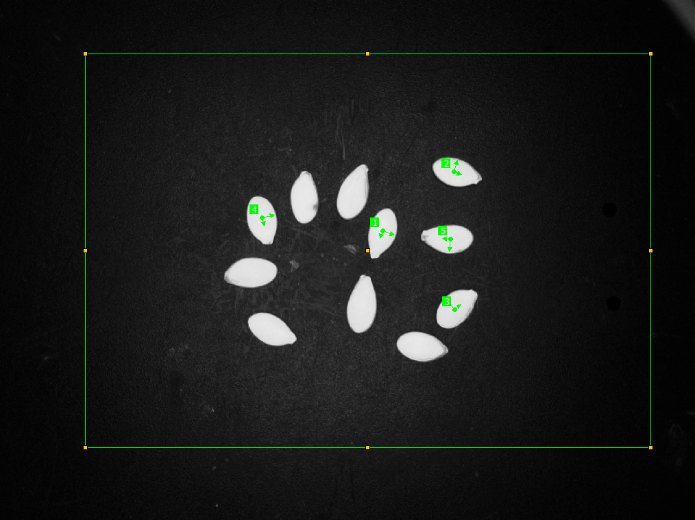

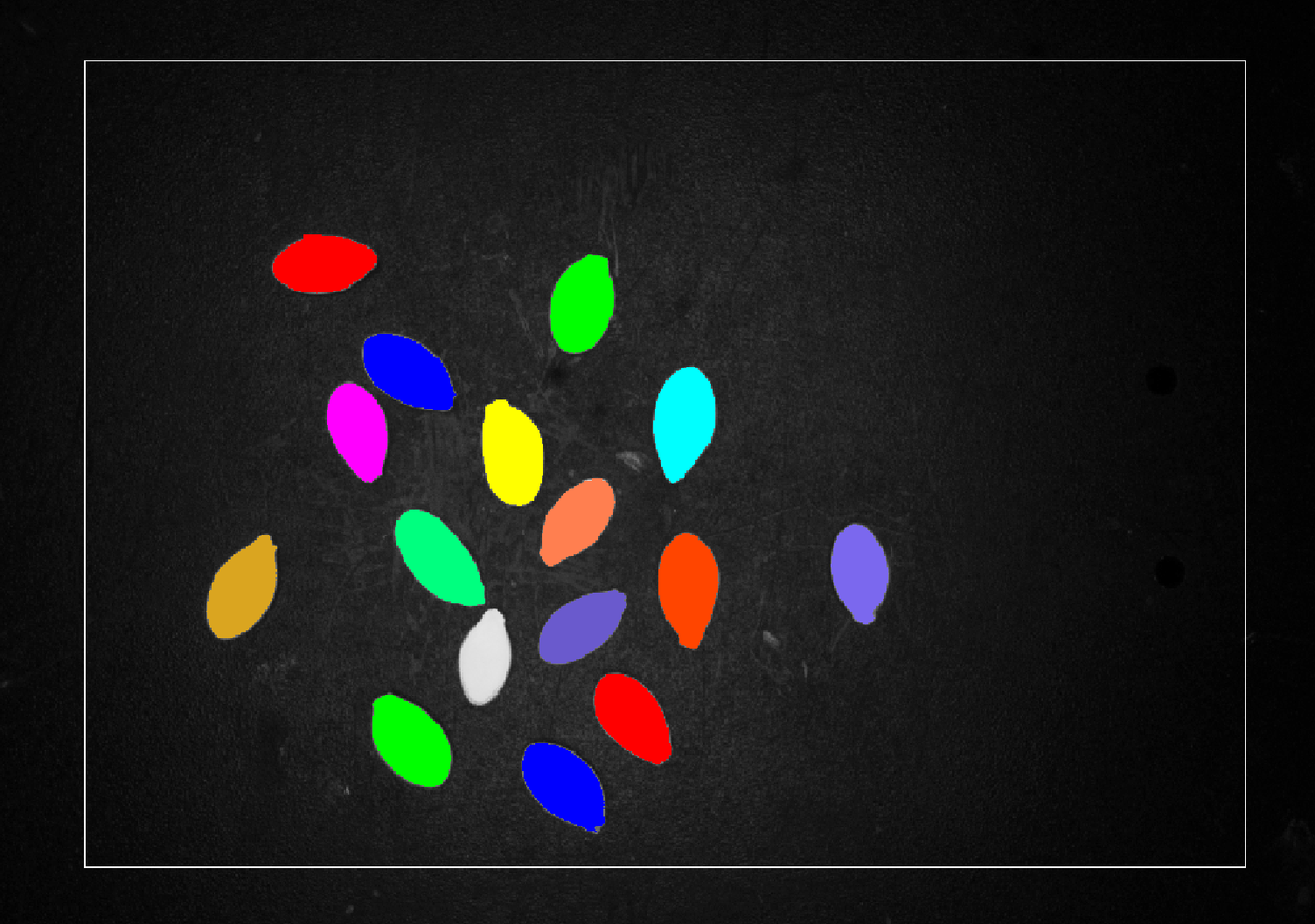

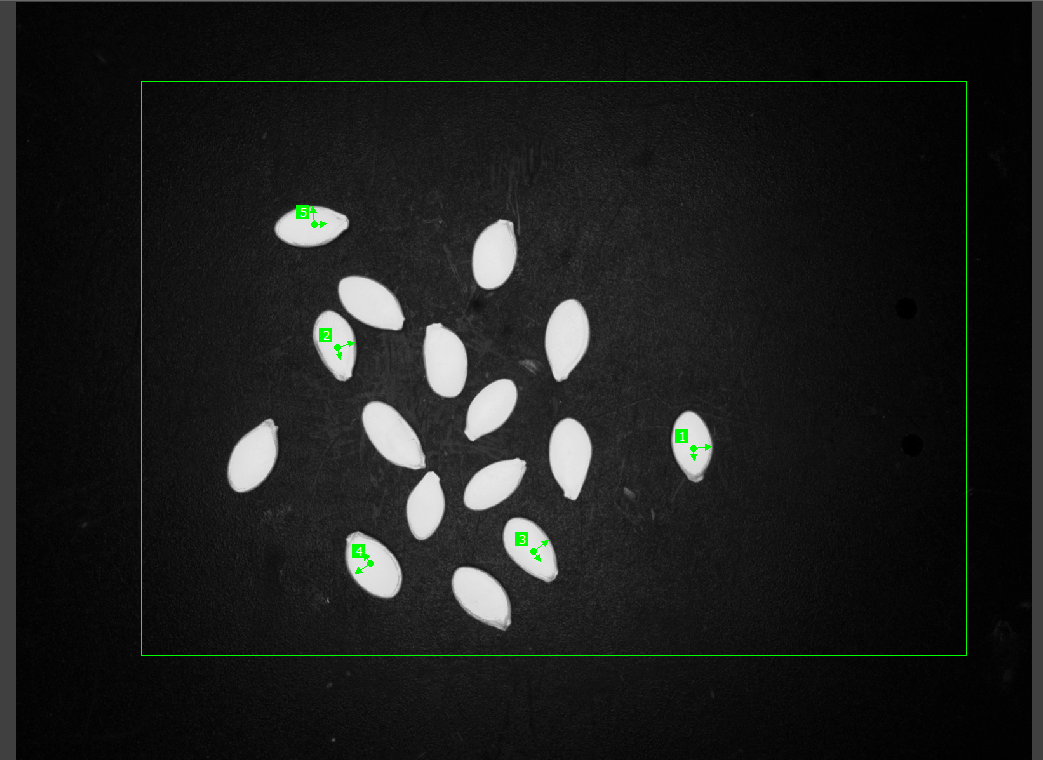

请问知道种子的面积之后,可以用什么方法让它从小到大识别出来,并且假如面积小于1500的话,属于不健康的种子,求助

可以直接通过面积筛选,也可得到所有种子的面积和坐标,筛选后根据坐标得到不满足的种子。
freekun139com 发表于 2023-9-19 15:19:35 | 显示全部楼层
打散后select_shape就行了吧,根据面积筛选
freekun139com 发表于 2023-9-19 15:24:54 | 显示全部楼层
  1. read_image (Image, 'D:/145154tx7xffph7hjhfxfa.png')
  2. decompose3 (Image, ImageR, ImageG, ImageB)
  3. binary_threshold (ImageG, Region, 'max_separability', 'light', UsedThreshold)
  4. connection (Region, ConnectedRegions)
  5. select_shape (ConnectedRegions, SelectedRegions, 'circularity', 'and', 0.4, 1)
  6. select_shape (SelectedRegions, SelectedRegions1, 'area', 'and', 0, 1500)
  7. region_features (SelectedRegions, 'area', Value)
  8. Greatereq := Value [>=] 1900
  9. Selected := select_mask([1:|Greatereq|], Greatereq)
  10. select_obj (SelectedRegions, ObjectSelected, Selected)
