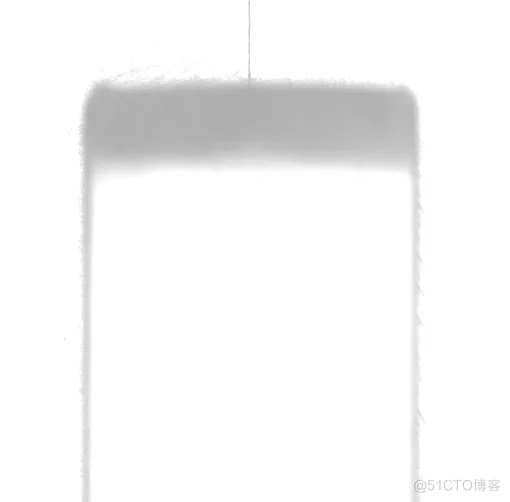

  2. read_image (Image, 'C:/Users/PC/Desktop/7-1.jpg')

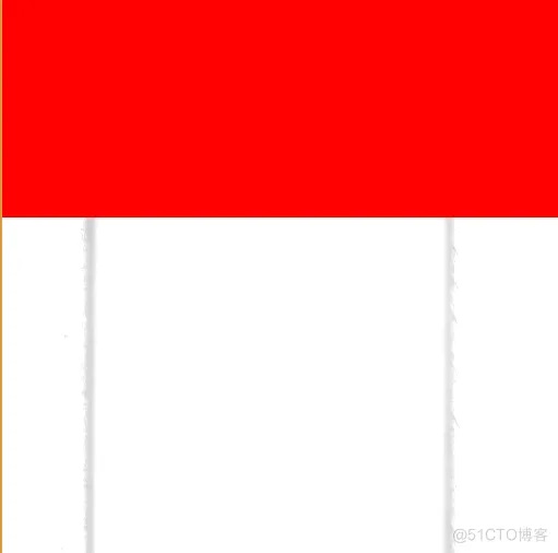

  6. gen_rectangle1(GrayImage, 100, 1500, 600, 3500)
  7. reduce_domain(Image, GrayImage, ImageReduced)

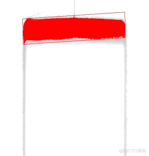

  9. threshold (ImageReduced, Region, 0, 195)
  10. *将非连通区域分割成一组区域的集合
  11. connection (Region, ConnectedRegions)
  12. *利用面积特征,将比较大快的区域分割出来
  13. select_shape(ConnectedRegions,selectRegion,'area','and',180000,250000)
  14. *求最小外接矩形
  15. smallest_rectangle2 (selectRegion, Row1, Column1, Phi, Length1, Length2)
  16. *根据矩形参数创建举行的轮廓
  17. gen_rectangle2_contour_xld (Snowcity, Row1, Column1, Phi, Length1, Length2)
  18. *显示最小外接矩形
  19. dev_set_window (WindowHandle)
  20. dev_set_draw ('margin')
  21. dev_set_line_width (3)
