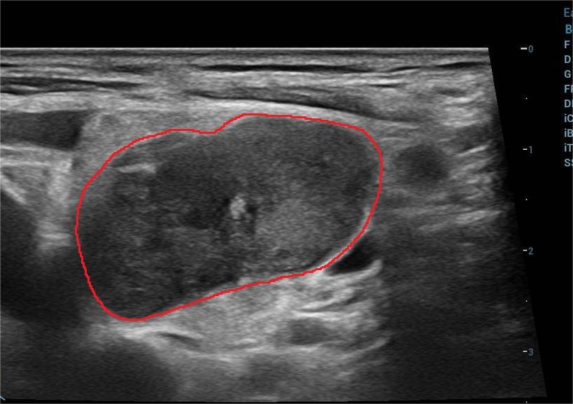

跪求各位大佬帮忙看看怎样把图片2的区域在图片1提取出来

gungun 发表于 2024-1-16 16:00:26 | 显示全部楼层
这是双胞胎?
 楼主| 9527wang 发表于 2024-1-16 16:03:06 | 显示全部楼层
emm这个是淋巴

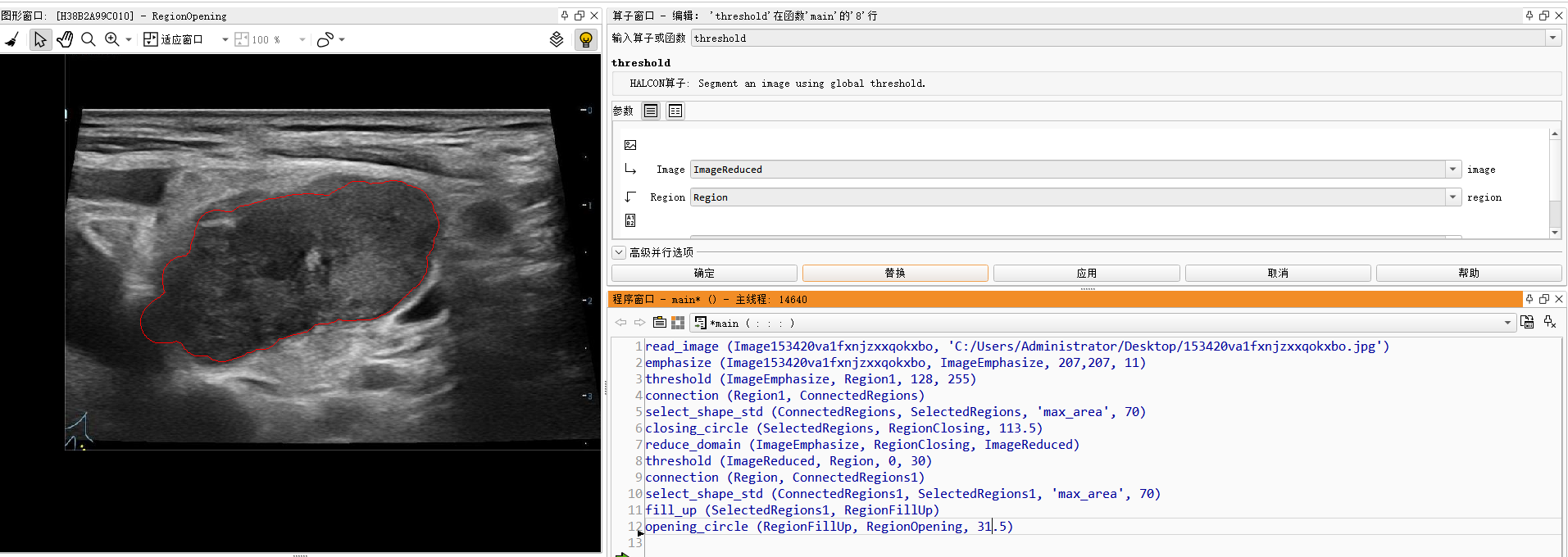

halcon2016 发表于 2024-1-17 10:05:02 | 显示全部楼层
  1. read_image (Image153420va1fxnjzxxqokxbo, 'C:/Users/Administrator/Desktop/153420va1fxnjzxxqokxbo.jpg')
  2. emphasize (Image153420va1fxnjzxxqokxbo, ImageEmphasize, 207,207, 11)
  3. threshold (ImageEmphasize, Region1, 128, 255)
  4. connection (Region1, ConnectedRegions)
  5. select_shape_std (ConnectedRegions, SelectedRegions, 'max_area', 70)
  6. closing_circle (SelectedRegions, RegionClosing, 113.5)
  7. reduce_domain (ImageEmphasize, RegionClosing, ImageReduced)
  8. threshold (ImageReduced, Region, 0, 30)
  9. connection (Region, ConnectedRegions1)
  10. select_shape_std (ConnectedRegions1, SelectedRegions1, 'max_area', 70)
  11. fill_up (SelectedRegions1, RegionFillUp)
  12. opening_circle (RegionFillUp, RegionOpening, 31.5)
不保证通用性,仅供参考
