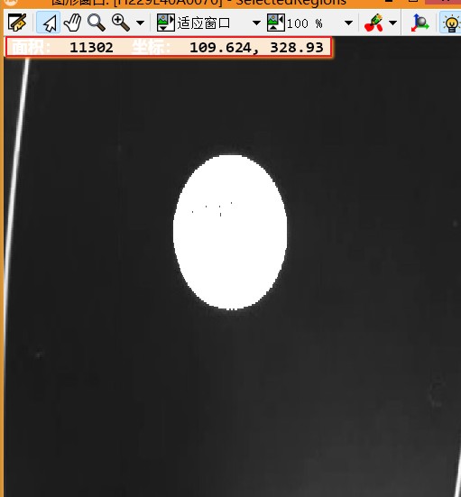

大佬们,图中数字颜色怎么无法修改呀?
CG_ZXL 发表于 2024-4-16 19:55:33 | 显示全部楼层 |阅读模式
  1. dev_close_window ()
  2. dev_open_window (0, 0, 512, 512, 'black', WindowHandle)
  3. set_display_font (WindowHandle, 16, 'mono', 'true', 'false')
  4. dev_set_color ('white')
  5. read_image (Image, 'F:/桌面/Halcon/素材/瓶盖.jpg')
  6. rgb1_to_gray (Image, GrayImage)
  7. threshold (GrayImage, Regions, 94, 255)
  8. connection (Regions, ConnectedRegions)
  9. select_shape (ConnectedRegions, SelectedRegions, 'area', 'and', 10541.2, 11648.2)
  10. dev_display (GrayImage)
  11. dev_display (SelectedRegions)
  12. area_center (SelectedRegions, Area, Row, Column)
  13. disp_message (WindowHandle, '面积: '+Area+'  坐标: '+Row+', '+Column, 'window',0,0, 'white', 'true')

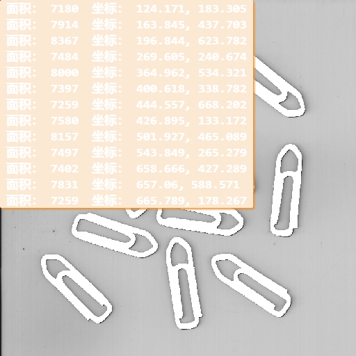

绝地武士 发表于 2024-4-16 20:06:26 | 显示全部楼层
我用clip图试了下,正常的,环境halcon18.11.3.0
