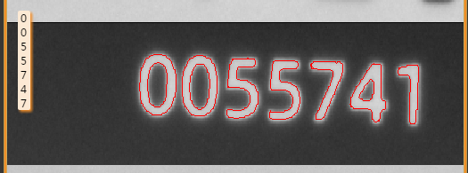

字符识别数字1识别为7
wh8888 发表于 2024-12-24 10:33:58 | 显示全部楼层 |阅读模式
  1. //顺时针斜还好一点儿,逆时针更差
  2. invert_image (doImageReduced, ImageInvert)
  3. threshold (ImageInvert, RegionSelecte, 170, 240)
  4. connection (RegionSelecte, ConnectedRegions)
  5. * 用圆形结构元素开运算
  6. opening_circle (ConnectedRegions, RegionOpening, 2.5)
  7. *计算每一个字符区域中心
  8. area_center (RegionOpening, Area1, Row, Column)
  9. *select_shape (ConnectedRegions, SelectedRegions, ['area','height'], 'and', [494.67,40], [1902.67,80])
  10. select_shape (RegionOpening, SelectedRegions, ['area','height'], 'and', [194.67,40], [1902.67,80])
  11. * 字符连通域排序
  12. sort_region (SelectedRegions, SortedRegions, 'first_point', 'true', 'column')
  13. *计算字符个数
  14. count_obj (SortedRegions, Number)
  15. *计算每一个字符区域中心
  16. area_center (SortedRegions, Area, Row, Column)
  17. try
  18.    max1  :=  max(Area)
  19. min1 := min(Area)
  20. catch (Exception)
  21. endtry
  1. read_ocr_class_mlp ('Industrial_0-9+_NoRej.omc', OCRHandle)
  2. do_ocr_multi_class_mlp (SortedRegions, doImageReduced, OCRHandle, Class, Confidence)
d5asdsadsa 发表于 2024-12-24 11:12:20 | 显示全部楼层
换个字符库  如不行自己训练字符库
