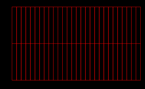

算子定义是
  1. add_metrology_object_line_measure( : : MetrologyHandle, RowBegin, ColumnBegin, RowEnd, ColumnEnd, MeasureLength1, MeasureLength2, MeasureSigma, MeasureThreshold, GenParamName, GenParamValue : Index)
其中,The half edge lengths of the measure regions perpendicular and tangential to the line are set in MeasureLength1 and MeasureLength2。
1,设置MeasureLength2=5(结果如图1)
图1
图1
  1. add_metrology_object_line_measure (MetrologyHandle, Row1, Column1, Row2, Column2, 80, 5, 10, 5, [], [], Index)

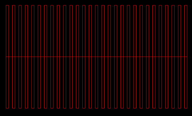

2,设置MeasureLength2=2(结果如图2,格子的宽度是减少了,但是间距增大了)
图2
图2
  1. add_metrology_object_line_measure (MetrologyHandle, Row1, Column1, Row2, Column2, 80, 2, 10, 5, [], [], Index)
但是,我想要的其实是把图1中每个格子的宽度调小一点,每个格子紧挨着,目的是想增多格子的数量,请问应该怎么操作呢(各位大佬救救我 help  help)

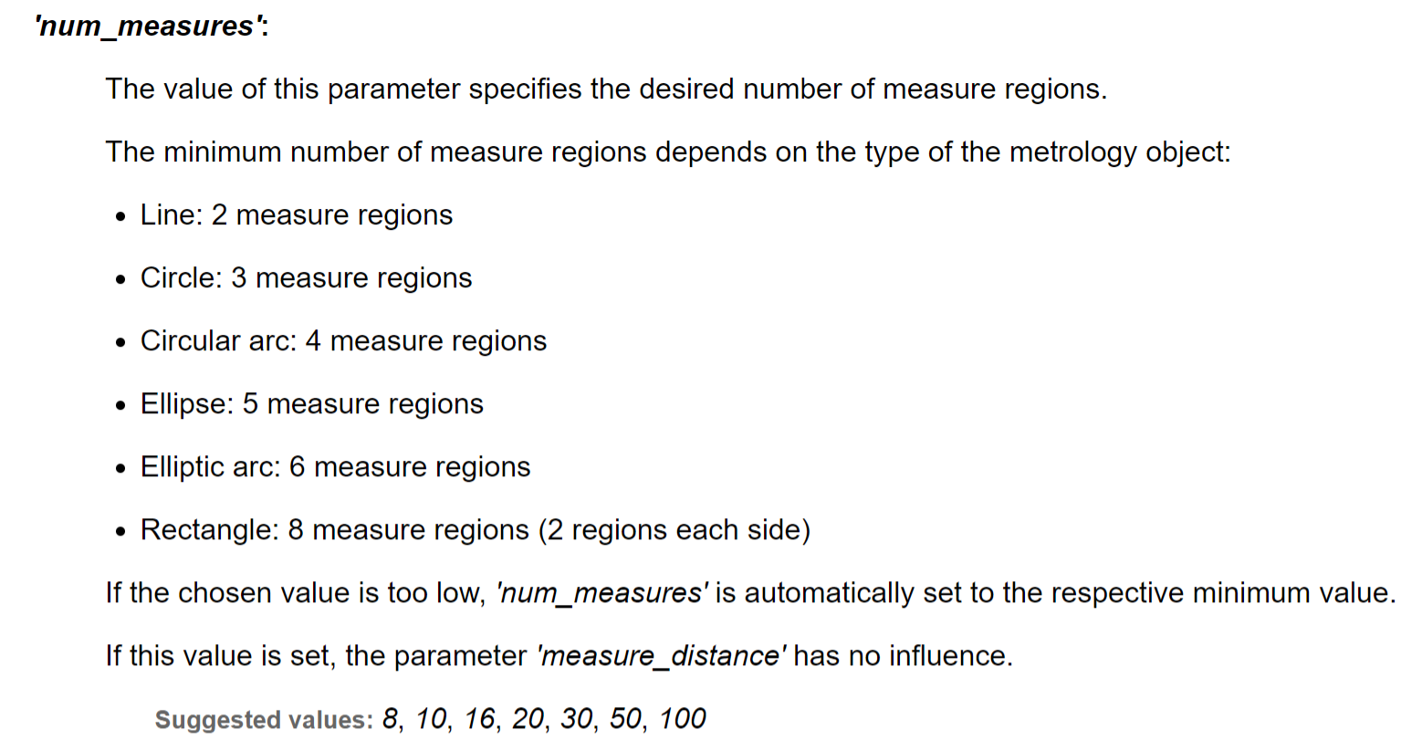

  1. add_metrology_object_line_measure (MetrologyHandle, Row1, Column1, Row2, Column2, 80, 5, 10, 2, 'num_measures', 50, Index)
小马哥 发表于 2025-3-7 15:59:15 | 显示全部楼层
'num_measures'这个参数是设定卡尺的个数的,把个数改多一些就可以了
miboss 发表于 2025-3-11 17:22:53 | 显示全部楼层
个数增多就可以了
