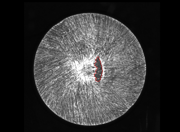

背景太复杂了,求助区域提取方法

这是陶瓷插芯吧?我之前做那个跟你这个正好相反,是要找周边磨砂区域
weicc 发表于 2022-12-1 14:53:19 | 显示全部楼层
  1. read_image (Image1, 'C:/Users/njtl003/Desktop/1.bmp')
  2. threshold (Image1, Region, 20, 255)
  3. opening_circle (Region, RegionOpening, 5.5)
  4. erosion_circle (RegionOpening, RegionErosion, 7.5)
  5. reduce_domain (Image1, RegionErosion, ImageReduced)
  6. mean_image (ImageReduced, ImageMean1, 51, 51)
  7. get_image_size (ImageMean1, Width, Height)
  8. watersheds_threshold (ImageMean1, Basins, 30)
  9. intensity (Basins, ImageMean1, Mean, Deviation)
  10. tuple_max (Deviation, Max)
  11. tuple_find (Deviation, Max, Indices)
  12. select_obj (Basins, ObjectSelected, Indices+1)
  13. reduce_domain (Image1, ObjectSelected, ImageReduced1)
  14. threshold (ImageReduced1, Region1, 0, 128)
  15. fill_up (Region1, RegionFillUp)
  16. opening_circle (RegionFillUp, RegionOpening1, 5.5)
  17. connection (RegionOpening1, ConnectedRegions)
  18. select_shape_std (ConnectedRegions, SelectedRegions, 'max_area', 70)
  19. dev_display (Image1)
  20. dev_display (SelectedRegions)
效果
效果
