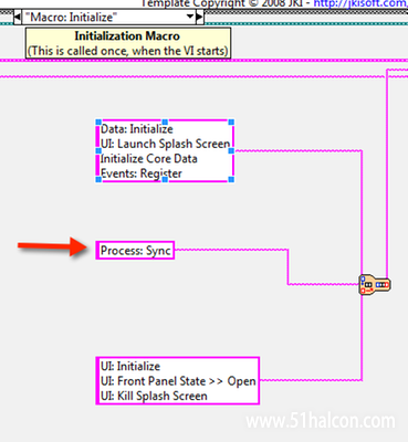

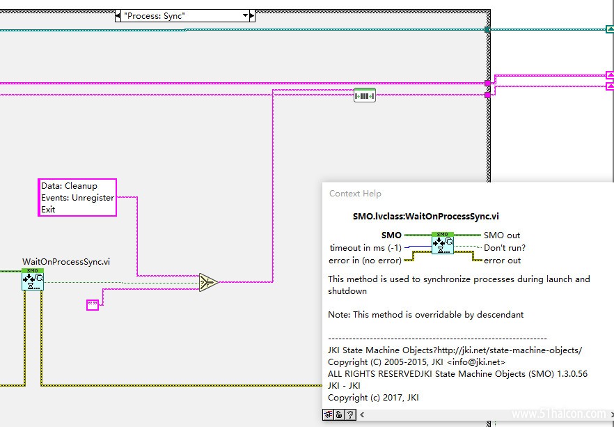

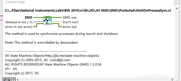

Process: Sync"
这个分支 JKI组织没有给出解释
查看
this  method is used  to  syschronize processes during  launcher or shutdown
此方法用于在启动或关闭过程中使进程同步
里面调用了好几层
999https://forums.ni.com/t5/JKI-Sta ... file.language=zh-CN
Hi Bruce,
thanks for uploading this code example. The issue is that your splash screen never completes its startup process because the registration is occurring during the registration process of your caller UI.
There are two considerations to solve your issue.
First of all, the "Process: Sync" frame is extremely important in "Process.vi" for any SMOs. That's the step that notifies the framework that event registrations have completed and that your component will not miss any important messages such as state changes, errors or more importantly, shutdown or abort signals... The overall state of your state machine object will remain "Created" until the stack of children implementations all reach the Process Sync frame, at which point the SMO will transition to "Started".
嗨布鲁斯,
感谢您上传此代码示例。问题是您的初始屏幕永远不会完成其启动过程,因为注册是在呼叫者UI的注册过程中进行的。
解决您的问题有两个注意事项。
首先,对于任何SMO,“ Process.vi”框架在“ Process.vi”中都非常重要。
这是向框架通知事件注册已完成的步骤,并且您的组件不会丢失任何重要消息,
例如状态更改,错误或更重要的是关闭或中止信号……
状态机对象的总体状态将保持为“已创建”,
直到所有子实现都到达“流程同步”帧,此时SMO将过渡到“已启动”。

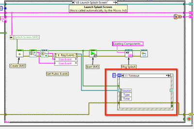

In your "Acquire and Log UI.lvclass:Process.vi", you need to perform all actions instantaneously or asynchronously to allow your SMO to start (aka. reach the Process: Sync frame).
在“获取并记录UI.lvclass:Process.vi”中,您需要立即或异步执行所有操作,以允许您的SMO启动(也就是到达Process:Sync框架)。
As you can see in the screenshot, your app currently waits forever in the "UI: Launch Splash Screen" and cannot sync, which is why it waits forever in the Start Processes vi.
从屏幕快照中可以看到,您的应用程序当前在“ UI:启动启动屏幕”中永远等待,并且无法同步,这就是为什么它在“启动流程” vi中永远等待的原因。
We will remove the blocking part (event structure) and interact with the splash screen asynchronously
我们将删除阻塞部分(事件结构),并与初始屏幕进行异步交互。
Secondly, it is not possible at the moment to Start a subprocess (SMO Splash in this case) while you are in the process of Starting your caller subsystem (Acquire and Log SMO). This means that you cannot call the "Start" method until after the "Process: Sync". But this is not what you want... so the current option is to call it before the Process.vi is called: essentially, you can override the "onStart" method to start your Splash screen before the process is launched. You can then use the "onStarted" override to close your splash screen.
Alternatively, I will be looking into a way to launch a component subsystem during the startup process: it is possible by making the Register Process method re-entrant... however I want to run unit tests to make sure this does not mess with other features, so this is not an option at the moment.
其次,在启动呼叫者子系统(获取并记录SMO)的过程中,目前无法启动子过程(在这种情况下为SMO Splash)。 这意味着您必须在“过程:同步”之后才能调用“开始”方法。 但这不是您想要的...,因此当前的选择是在调用Process.vi之前调用它:本质上,您可以覆盖“ onStart”方法以在启动进程之前启动您的启动画面。 然后,您可以使用“ onStarted”替代关闭初始屏幕。
另外,我将研究一种在启动过程中启动组件子系统的方法:可以通过使Register Process方法重新进入来实现...但是我想运行单元测试以确保它不会与其他组件混淆 功能,因此目前无法选择。

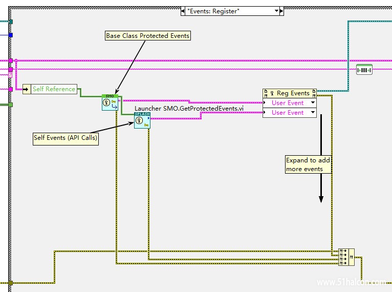

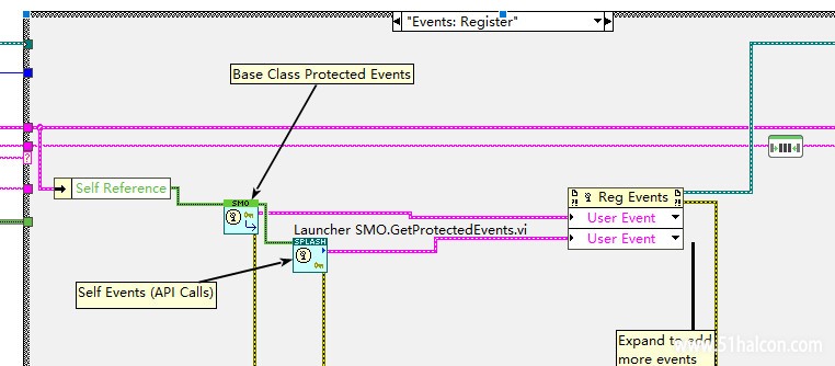

 楼主| wenluderen 发表于 2021-3-26 16:26:34 | 显示全部楼层
"Events: Register"
将SMO里面新建的事件  , 和 用户事件结构建立联系

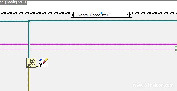

 楼主| wenluderen 发表于 2021-3-26 16:28:38 | 显示全部楼层
"Events: Unregister"
这个没啥好说
用户事件结构 常规操作,
程序结束后必须调用Unregister For Events
避免内存泄漏
至于Events: Unregister"   何时会运行,前文里面至少两个宏里面 提到这个玩意了

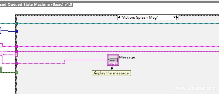

 楼主| wenluderen 发表于 2021-3-26 16:30:42 | 显示全部楼层
"Action: Notify UI Closed"
Notify that the UI has been closed
"Action: Splash Msg"   这个就是新的消息的执行分支了
后续改写代码的另一个主要地方,就是添加新的case分支处理  消息
 楼主| wenluderen 发表于 2021-3-26 17:34:23 | 显示全部楼层
后记1:
启动过程的消息
Macro: Initialize---------->
Data: Initialize
Initialize Core Data
Events: Register
最后没有消息可以处理 ,就进入默认分支;

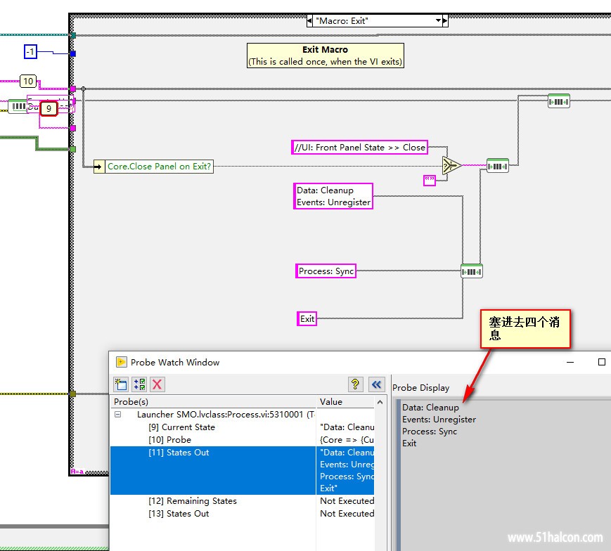

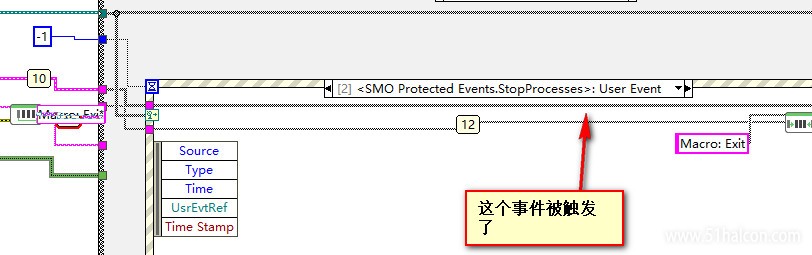

后记2:
停止过程的消息:
关闭SMO 导致
然后就是 Macro:EXIT   这个消息写入队列
后记3:

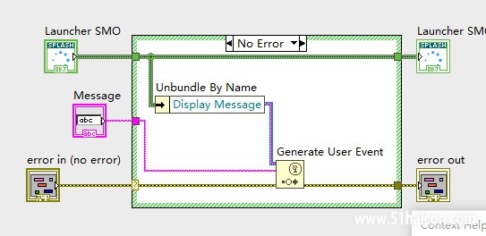

 楼主| wenluderen 发表于 2021-3-26 17:54:23 | 显示全部楼层
Send Splash Message.vi里面的消息的传递过程
第一步:第0步:Loading Components...(加载组件) 作为参数 进入Send Splash Message.vi
第二步:在Send Splash Message.vi 里面 使用Generate User Event  将  第0步:Loading Components...(加载组件) 作为用户事件的参数传递进去。
用户事件的名字是:SMO的一个成员数据
第三步:
  通过下图的代码,决定了    "", "Idle"  里面的  事件结构可以写响应函数
第四步:在事件结构写响应函数
第五步:
将Action: Splash Msg   消息 ,  消息的参数:第0步:Loading Components...(加载组件)
写到消息队列里面
第六步:
这是最后一步了
在进入对应的case 消息分支  第0步:Loading Components...(加载组件)
作为消息参数,传递进来
结束

遗留两个问题:
1) "Process: Sync"  这个分支具体内容具体是什么,如何实现
