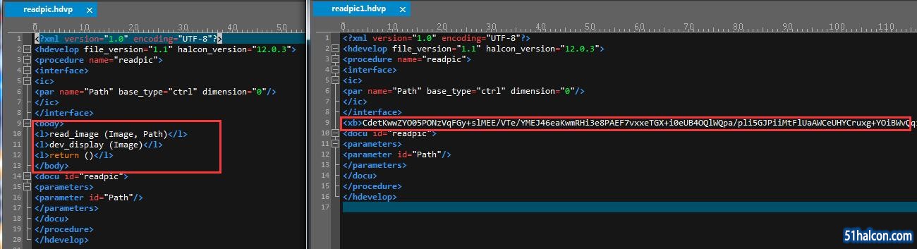

好像没得找回的办法

Warning
When working with protected procedures, be aware that the password cannot be reconstructed, so be very careful not to forget it and not to repeat a typing error when assigning it! Further, in some situations protected procedures behave differently from common procedures. In particular, as they cannot be viewed and modified by unauthorized users, they also cannot be copied, printed, or exported to any programming language (however, they can be duplicated using the menu entry Menu Procedures ⇒ Duplicate...). Additionally, if a protected procedure contains a call to another procedure for which the interface was changed, the procedure call is not adapted to the changes but is disabled for the current program.
官方说明,请自行记好自己的密码,忘记密码是无法找回和恢复的!
