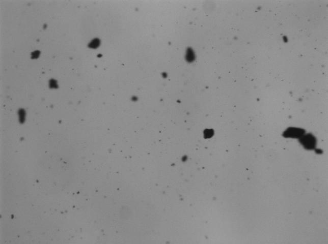

怎么检测这些颗粒的长径和短径呢,小白刚学习,研究许久不得要领啊

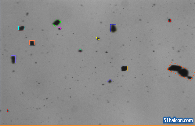

边缘没法有效提取,那就简单试试Blob提取吧!
  1. read_image (Image, 'C:/Users/Admin/Desktop/1.bmp')
  2. binary_threshold (Image, Region, 'max_separability', 'dark', UsedThreshold)
  3. connection (Region, ConnectedRegions)
  4. select_shape (ConnectedRegions, SelectedRegions, 'area', 'and', 30, 99999)
  5. smallest_rectangle2 (SelectedRegions, Row, Column, Phi, Length1, Length2)
  6. gen_rectangle2 (Rectangle, Row, Column, Phi, Length1, Length2)
  7. dev_set_draw ('margin')
  8. dev_display (Image)
  9. dev_display (Rectangle)

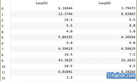

这个算法是有精度误差的,而且效果不是很好,但是可以给你一定思路,因为边缘一定要通过边缘提取出来才可以,你这个不规则有点难度!
初步得出来的长半轴和短半轴数据:
