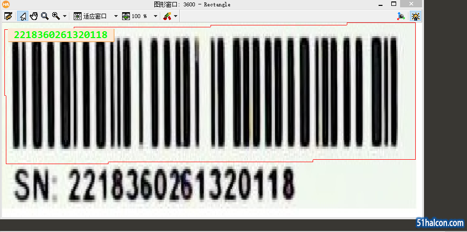

may be your image resolution not enough!
only this image can be decoded on beblow
my codes:
  1. dev_set_draw ('margin')
  2. set_display_font (3600, 20, 'mono', 'true', 'false')
  3. create_bar_code_model ([], [], BarCodeHandle)
  4. *set_bar_code_param (BarCodeHandle, 'train', 'all')
  5. for Index := 1 to 2 by 1
  6.     read_image (Image, 'test' + Index + '.jpg')
  7.     draw_rectangle2 (3600, Row, Column, Phi, Length1, Length2)
  8.     gen_rectangle2 (Rectangle, Row, Column, Phi, Length1, Length2)
  9.     decode_bar_code_rectangle2 (Image, BarCodeHandle, 'auto', Row, Column, Phi, Length1, Length2, DecodedDataStrings)
  10.     disp_message (3600, DecodedDataStrings, 'window', 12, 12, 'green', 'true')
  11.     stop()
  12. *    find_bar_code (Image, SymbolRegions, BarCodeHandle, 'auto', DecodedDataStrings)
  13. endfor

I tried your codes on HALCON 13. But it didn't find any barcodes. Which version of HALCON do you use?
Thanks for information.
敢问 这个为什么不是创建条码模型直接create_bar_code_model ([], [], BarCodeHandle)然后直接find_bar_code (Image, SymbolRegions, BarCodeHandle, 'Code 128', DecodedDataStrings)呢?
Criss 发表于 2018-9-18 14:53:57 | 显示全部楼层
852474220 发表于 2018-9-18 14:12
敢问 这个为什么不是创建条码模型直接create_bar_code_model ([], [], BarCodeHandle)然后直接find_bar_c ...
他是要用训练模式去识别条码,而且这个条码确实不容易识别出来!
而且直接根据条码模型去识别也识别不出来,不信你试试看,应该是分辨率不够!
