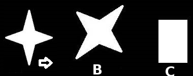

I want to create a module with OPENCV like on below. But function of opencv which is cv.matchShapes(...), support only a contour for searching. How can I create a reference model which has multiple contours with OPENCV?
Information: (contour1 is not supported for multiple contours)
  1. Python: cv2.matchShapes(<b>contour1</b>, contour2, method, parameter)

Belial2010 发表于 2018-10-5 14:56:06 | 显示全部楼层
你可以自己扩展,加个循环,遍历比较多个轮廓。
 楼主| Halcon_ 发表于 2018-10-6 15:05:07 | 显示全部楼层
for example, reference model has 5 contours and test image have 1000 contours. How can I match reference model with contours which is on image of test correctly?
According to me, It can be a mistake when contours are tried to matching one-to-one. Because, Test image can consist of more contours or less contours according to reference model.
