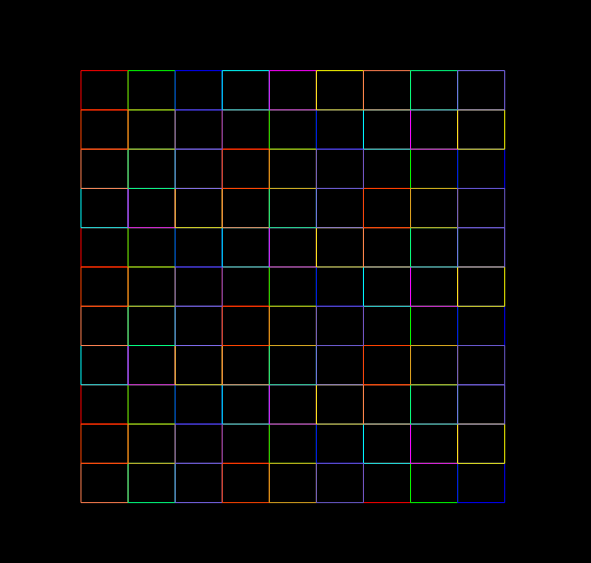

freekun139com 发表于 2023-9-14 18:12:41 | 显示全部楼层
*一个一个画出来是否可行
RowStart := 100
ColStart := 100
RowSteps := 50
ColSteps := 60
gen_empty_obj (GridObjects)
for Row := 0 to 10 by 1
    for Col := 0 to 8 by 1
        gen_rectangle2_contour_xld (Rectangle, RowStart+Row*RowSteps, ColStart+ColSteps*Col, rad(90), 0.5*RowSteps, 0.5*ColSteps)
        concat_obj (GridObjects, Rectangle, GridObjects)
    endfor
endfor
