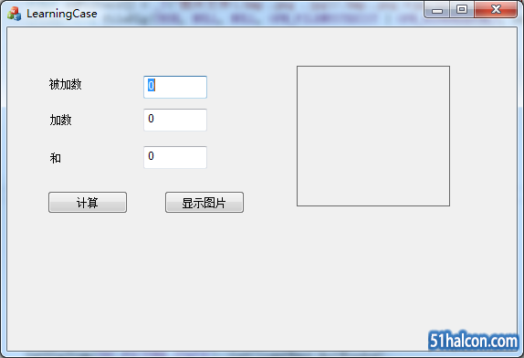

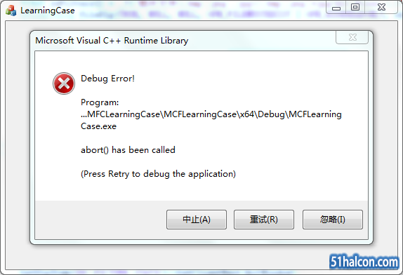

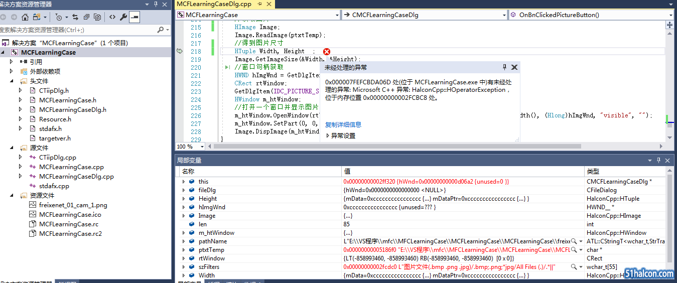

在mfc中点击显示图片按钮,将图片显示在picture control上,报错似乎内存溢出,图片不能显示,哪儿错了呢???

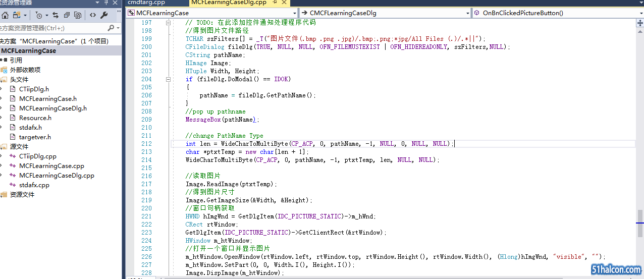

代码如下////////////////////////
void CMCFLearningCaseDlg::OnBnClickedPictureButton()
        // TODO: 在此添加控件通知处理程序代码

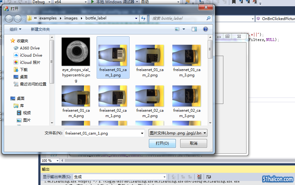

        //得到图片文件路径
        TCHAR szFilters[] = _T("图片文件(.bmp .png .jpg)/.bmp;.png;*jpg/All Files (.)/.*||");
        CFileDialog fileDlg(TRUE, NULL, NULL, OFN_FILEMUSTEXIST | OFN_HIDEREADONLY, szFilters,NULL);
        CString pathName;
        HImage Image;
        HTuple Width, Height;
        if (fileDlg.DoModal() == IDOK)
                pathName = fileDlg.GetPathName();
        //pop up pathname
        MessageBox(pathName);
        //change PathName Type
        int len = WideCharToMultiByte(CP_ACP, 0, pathName, -1, NULL, 0, NULL, NULL);
        char *ptxtTemp = new char[len + 1];
        WideCharToMultiByte(CP_ACP, 0, pathName, -1, ptxtTemp, len, NULL, NULL);
        //读取图片
        Image.ReadImage(ptxtTemp);
        //得到图片尺寸
        Image.GetImageSize(&Width, &Height);
        //窗口句柄获取
        HWND hImgWnd = GetDlgItem(IDC_PICTURE_STATIC)->m_hWnd;
        CRect rtWindow;
        GetDlgItem(IDC_PICTURE_STATIC)->GetClientRect(&rtWindow);
        HWindow m_htWindow;
        //打开一个窗口并显示图片
        m_htWindow.OpenWindow(rtWindow.left, rtWindow.top, rtWindow.Height(), rtWindow.Width(), (Hlong)hImgWnd, "visible", "");
        m_htWindow.SetPart(0, 0, Width.I(), Height.I());
        Image.DispImage(m_htWindow);

这个是怎么错了呢,把Width 和Height赋初值NULL也是同样报错。
是文件路径有错吗?
