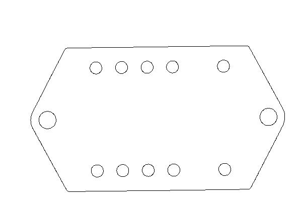

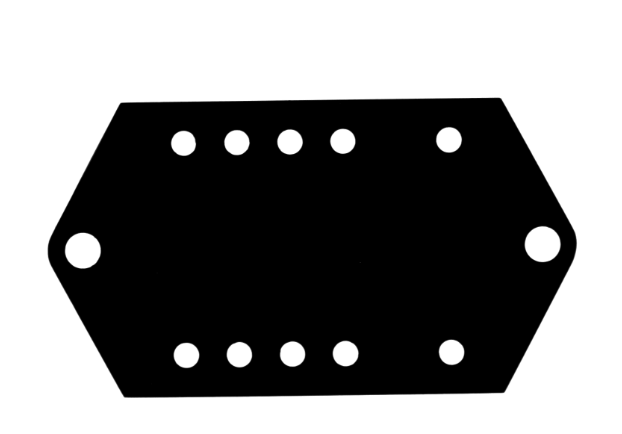

问:怎么把边缘变成黑色 背景变成白色 求程序  即原图边缘检测后的效果图边缘是黑色的 背景是白色的

  1. read_image (Image, '孔心距测量.png')
  2. edges_color_sub_pix (Image, Edges, 'canny', 1, 20, 40)
  3. gen_image_proto (Image, Image2, 255)
  4. dev_set_color ('black')
  5. dev_display (Edges)

  1. read_image (Image, 'C:/Users/Administrator/Desktop/边缘提取/孔心距测量.png')
  4. dev_set_color ('red')
  5. dev_display (Image)
  6. dev_display (Edges)
