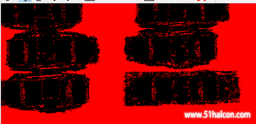

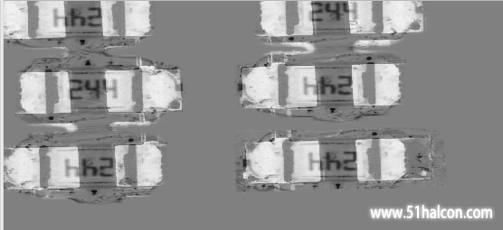

对第一张电阻图进行处理
threshold(ImageSub,Region,128,128)
得到第二张图,怎么得出分立的连通域,最后读出图中有6个电阻?
萝卜菌 发表于 2022-3-29 14:45:36 | 显示全部楼层
read_image (Image, 'C:/Users/SWD-AR09/Desktop/161125qnm0zomboafbjk4a.png')
rgb1_to_gray (Image, GrayImage)
threshold (GrayImage, Regions, 175, 255)
opening_circle (Regions, RegionOpening, 3.5)
closing_rectangle1 (RegionOpening, RegionClosing, 50, 1)
connection (RegionClosing, ConnectedRegions)
select_shape (ConnectedRegions, SelectedRegions, 'area', 'and', 5000, 99999)
