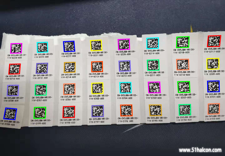

全图多个二维码完整识别
绝地武士 发表于 2021-5-26 20:53:27 | 显示全部楼层 |阅读模式
  1. dev_set_line_width (3)
  2. read_image (Image, 'C:/Users/Criss/Desktop/2.jpg')
  3. create_data_code_2d_model ('Data Matrix ECC 200', [], [], DataCodeHandle)
  4. find_data_code_2d (Image, SymbolXLDs, DataCodeHandle, ['stop_after_result_num'], ['50'], ResultHandles, DecodedDataStrings)
