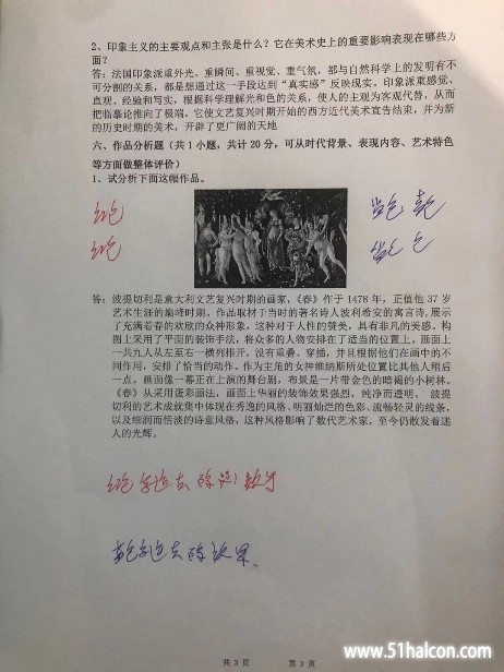

消除红蓝颜色字体
lyf 发表于 2021-6-11 21:30:31 | 显示全部楼层 |阅读模式
求大佬帮忙!!!
halcon2016 发表于 2021-6-16 18:09:16 | 显示全部楼层
read_image (Image212932m0xgog96g065z9yn, 'C:/Users/Administrator/Desktop/新建文件夹/212932m0xgog96g065z9yn.jpg')
decompose3 (Image212932m0xgog96g065z9yn, Image1, Image2, Image3)
trans_from_rgb (Image1, Image2, Image3, ImageResult11, ImageResult22, ImageResult33, 'cielab')
mean_image (ImageResult22, ImageMean, 29, 29)
dyn_threshold (ImageResult22, ImageMean, RegionDynThresh, 4, 'light')
connection (RegionDynThresh, ConnectedRegions)
select_shape (ConnectedRegions, SelectedRegions, 'area', 'and', 10, 99999)
union1 (SelectedRegions, RegionUnion)
dilation_rectangle1 (RegionUnion, RegionDilation, 31, 21)
paint_region (RegionDilation, Image1, ImageResult4, 176, 'fill')
paint_region (RegionDilation, Image2, ImageResult5, 172, 'fill')
paint_region (RegionDilation, Image3, ImageResult6, 163, 'fill')
compose3 (ImageResult4, ImageResult5, ImageResult6, MultiChannelImage)
zeroplants 发表于 2021-7-1 10:38:23 | 显示全部楼层
建議使用inpainting_texture比較來得穩定。

halcon2016 发表于 2021-7-5 11:12:01 | 显示全部楼层
read_image (Image, 'C:/Users/yoyo/Desktop/1.jpg')
厉害了,这个方法效果真不错!!

stq002285 发表于 2021-7-18 16:45:03 | 显示全部楼层
将zeroplants的方法转为OpenCV实现:Halcon转OpenCV实例--去除纸张中的颜色笔迹/墨迹(附源码)https://mp.weixin.qq.com/s?__biz=MzU5NDM1MjU5Mg==&tempkey=MTEyMl9YRnVPSGQ5bmtvaHZBWC8rWWdyMUJCVHd6b3ZCMjBNRm5ZMjRHclpfQXNvRjl5TUR3ZW85U3hjaTJsdkNWSXd3WWd0clhCeTlKcm0wbm1YT09sR0U0c1BuMVNuMm1wemVsSjQ5MFJpS25qVFVwa2htRlVlVW5JQi1RRUlSY2xsREl3b0tSNTZsbUN2dmZncjdJZ05pa1FHSzlFbUUyd0FHbjY5bkF3fn4%3D&chksm=7e03cbf3497442e581358b895b8da7e7e88744c89ca2194ce91f890a686668824ee2f6a976ab#rd
