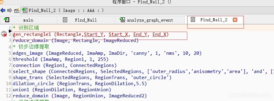

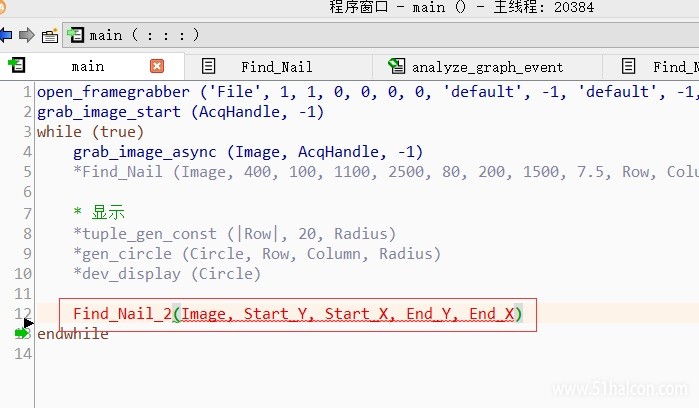

halcon 改变了函数的参数报这个错,请问是什么原因?
youyiyang 发表于 2021-10-11 11:52:46 | 显示全部楼层 |阅读模式
绝地武士 发表于 2021-10-11 12:47:38 | 显示全部楼层
Find_Nail_2(Image::AAA:) 你这个函数只有两个参数呢?你下图Line12里面是5个参数。

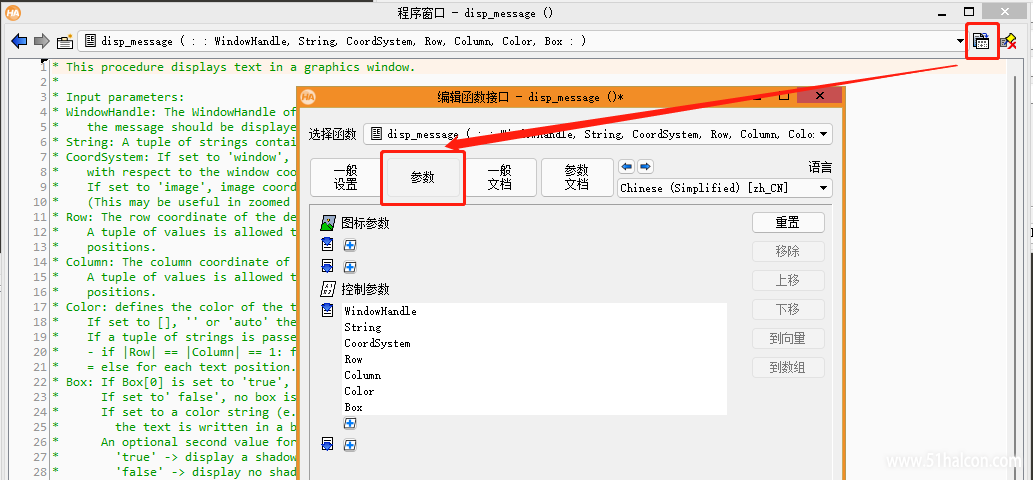

 楼主| youyiyang 发表于 2021-10-11 20:33:05 | 显示全部楼层
请问怎么修改参数及其数量?
绝地武士 发表于 2021-10-11 21:22:52 | 显示全部楼层
请问怎么修改参数及其数量?
任何外部函数上面右键“显示函数”(alt+return),进入函数后右上角“编辑当前函数的接口和文档”。 微信截图_20211011212234.png
 楼主| youyiyang 发表于 2021-10-12 16:58:51 | 显示全部楼层
public void Recognize(HImage image)
                        _halcon.Find_Nail_2(image, UpLeftY, UpLeftX, DownRightY, DownRightX, out HTuple row, out HTuple col);
                        var len = row.Length;
                        Nail_x = new int[len];
                        Nail_y = new int[len];
                        for (int i = 0; i < len; i++)
                                Nail_x[i] = (int)((double)col[i]);
                                Nail_y[i] = (int)((double)row[i]);
C#的程序是这样的,那么halcon上面应该怎么改写呢?

绝地武士 发表于 2021-10-12 17:38:03 | 显示全部楼层
                        _halcon.Find_Nail_2(image, UpLeftY, UpLeftX, DownRightY,  ...
Halcon参数签名:
Find_Nail_2(image :: UpLeftY, UpLeftX, DownRightY, DownRightX : row, col)

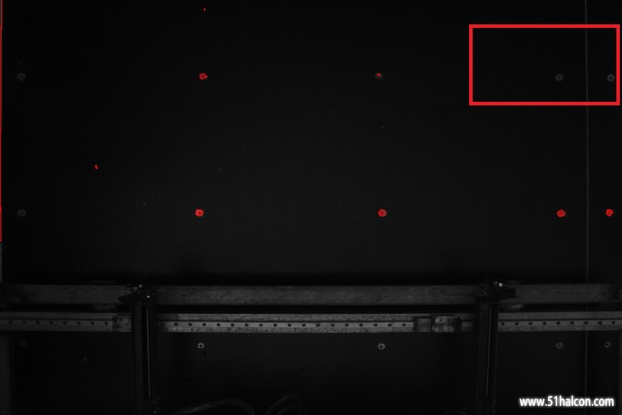

 楼主| youyiyang 发表于 2021-10-14 11:18:20 | 显示全部楼层
edges_image (ImageReduced, ImaAmp, ImaDir, 'canny', 1, 'nms', 10, 20)
threshold (ImaAmp, Region1, 1, 255)
connection (Region1, ConnectedRegions)
select_shape (ConnectedRegions, SelectedRegions, ['outer_radius','anisometry','area'], 'and', [10,1,50], [30,3.9,300])
shape_trans (SelectedRegions, RegionTrans, 'outer_circle')
dilation_circle (RegionTrans, RegionDilation,5.5)
union1 (RegionDilation, RegionUnion)
reduce_domain (Image, RegionUnion, ImageReduced2)
请问程序哪里可以调整灰度值,可让右上角红色框内的两个很淡的圆形钉子识别出来
