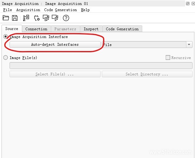

大胡子怪叔叔 发表于 2021-11-19 16:49:54 | 显示全部楼层
Evgeniy 发表于 2021-11-19 11:13
That is the problem.
These cameras haven't SDK. These devices are USB Plug And Play.
As shown above,Halcon Acquisition assistant,All camera interfaces are supported,you can try it yourself.

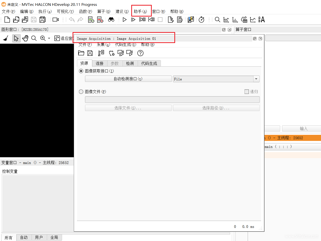

Criss 发表于 2021-11-19 17:13:02 | 显示全部楼层
Evgeniy 发表于 2021-11-18 13:17
My camera is Logitech HD Webcam 270!
It is for now.
you can trying this auto scanning  by the image acquisition assistant. if not found any cameras,it could be not supportted.

 楼主| Evgeniy 发表于 2021-11-22 16:52:39 | 显示全部楼层
Hi, Criss!
Thank you, your solution is the best!!!
