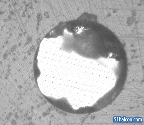

要求提取图片中的圆??
Princess 发表于 2016-10-12 15:24:42 | 显示全部楼层 |阅读模式
要求,提取图中效果不是很好的那个圆形区域,同时计算圆心度。
原图地址:https://pan.baidu.com/s/1i5BHdWD

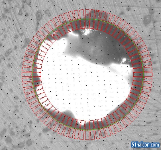

用鸟叔的spoke算子或者halcon自带的metrology都可以,可以参考:
  1. read_image (Image, 'rings_and_nuts')
  2. create_metrology_model (MetrologyHandle)
  3. get_image_size (Image, Width, Height)
  4. set_metrology_model_image_size (MetrologyHandle, Width, Height)
  5. add_metrology_object_circle_measure (MetrologyHandle, 120, 130, 35, 10, 2, 1, 30, ['measure_distance'], [40], Index)
  6. apply_metrology_model (Image, MetrologyHandle)
  7. get_metrology_object_result (MetrologyHandle, Index, 'all', 'result_type', 'all_param', Circle)
  8. get_metrology_object_result_contour (Contour, MetrologyHandle, Index, 'all', 1.5)
  9. clear_metrology_model (MetrologyHandle)
