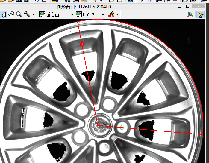

求教 怎么拿到这两点 希望通过这两点划分一个扇形进行切割

laihuaxun2004 发表于 2022-12-31 21:46:27 | 显示全部楼层
只有一张图,没法测鲁棒性。用均值滤波算子筛选的。
  1. dev_update_off ()
  2. dev_close_window ()
  3. read_image (Image, 'E:/Users/laihuaxun/Desktop/halcon 学习资料/TEST Image/122029fj2s700b74e0jjaa.png')
  4. get_image_size (Image, Width, Height)
  5. dev_open_window (0, 0, Width, Height, 'black', WindowHandle)
  6. dev_display (Image)
  7. *找到大圆
  8. threshold (Image, Region, 120, 255)
  9. smallest_circle (Region, Row, Column, Radius)
  10. *找两个小点
  11. mean_image (Image, ImageMean, 13, 13)
  12. dyn_threshold (Image, ImageMean, RegionDynThresh, 11, 'dark')
  13. connection (RegionDynThresh, ConnectedRegions)
  14. fill_up (ConnectedRegions, RegionFillUp)
  15. select_shape (RegionFillUp, SelectedRegions, ['area','inner_radius','outer_radius'], 'and', [100,4,6], [200,10,15])
  16. opening_circle (SelectedRegions, RegionOpening, 3.5)
  17. count_obj (RegionOpening, Number)
  18. if (Number#2)
  19.     stop ()
  20. endif
  21. shape_trans (RegionOpening, RegionTrans, 'inner_circle')
  22. smallest_circle (RegionTrans, Row2, Column2, Radius1)
  23. gen_circle (Circle, Row2, Column2, Radius1)
  24. *测量角度
  25. angle_lx (Row, Column, Row2[0], Column2[0], Angle1)
  26. angle_lx (Row, Column, Row2[1], Column2[1], Angle2)
  27. *画扇形
  28. gen_circle_sector (CircleSector, Row, Column, Radius,rad(360)+Angle2,Angle1)
  29. dev_set_draw ('margin')
  30. dev_set_line_width (2)
  31. dev_display (Image)
  32. dev_display (Circle)
  33. dev_display (CircleSector)
