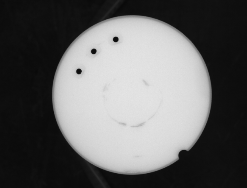

如附件图所示,白色的片片上会有一些划痕或者脏污的检测。
难度在于这个白色片片OK件也存在灰度不同的(差别不大)情况,这种用什么方法检测?
附件增加模拟提高亮度的图
2020-07-24_09_49_41_139.zip (514.49 KB, 下载次数: 21)

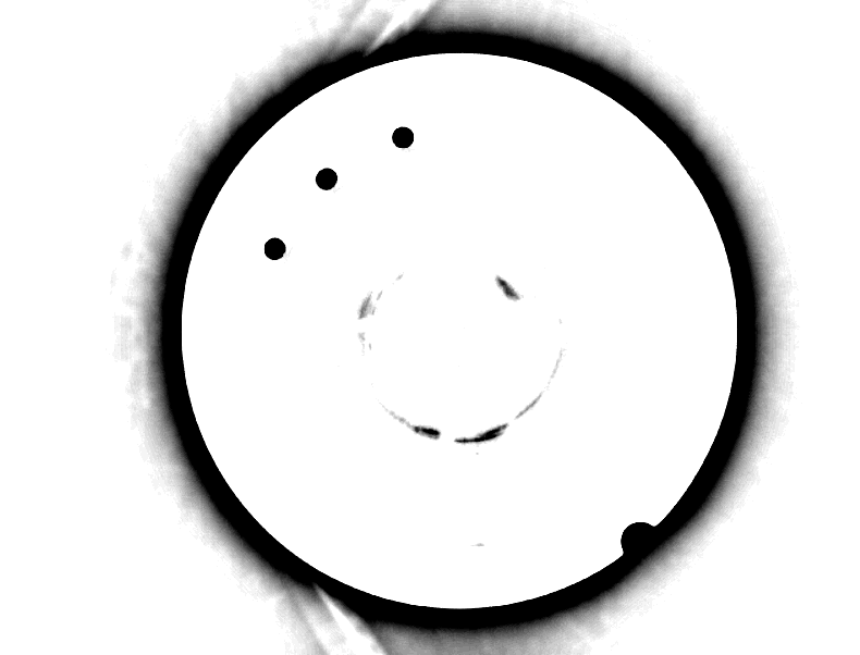

 楼主| 芜湖小肖 发表于 2023-2-16 10:50:18 | 显示全部楼层
附件增加模拟提高亮度的图
2020-07-24_09_34_36_991.zip (515.02 KB, 下载次数: 12) 3.zip (515.5 KB, 下载次数: 12) 2.zip (515.51 KB, 下载次数: 10) 1.zip (515.51 KB, 下载次数: 9)
暗翼小哥 发表于 2023-2-16 16:48:21 | 显示全部楼层
楼主麻烦指出瑕疵的地方还有就是OK的图像是什么样的?
雾里看花 发表于 2023-2-17 08:34:54 | 显示全部楼层
深度学习吧,比较稳定些
 楼主| 芜湖小肖 发表于 2023-2-20 15:39:55 | 显示全部楼层
全白色是ok件
freekun139com 发表于 2023-4-2 15:18:40 | 显示全部楼层
* Image Acquisition 01: Code generated by Image Acquisition 01
list_files ('D:/白色背景的脏污检测', ['files','follow_links'], ImageFiles)
tuple_regexp_select (ImageFiles, ['\\.(tif|tiff|gif|bmp|jpg|jpeg|jp2|png|pcx|pgm|ppm|pbm|xwd|ima|hobj)$','ignore_case'], ImageFiles)
for Index := 0 to |ImageFiles| - 1 by 1
    read_image (Image, ImageFiles[Index])
    * Image Acquisition 01: Do something
    binary_threshold (Image, Region, 'max_separability', 'light', UsedThreshold)
    connection (Region, ConnectedRegions)
    select_shape_std (ConnectedRegions, SelectedRegions, 'max_area', 70)
    fill_up (SelectedRegions, RegionFillUp)
    reduce_domain (Image, RegionFillUp, ImageReduced)
    mean_image (ImageReduced, ImageMean1, 3, 3)
    mean_image (ImageReduced, ImageMean2, 35, 35)
    dyn_threshold (ImageMean1, ImageMean2, RegionDynThresh, 3, 'dark')
    closing_circle (RegionDynThresh, RegionClosing, 3.5)
    connection (RegionClosing, ConnectedRegions1)
    select_shape (ConnectedRegions1, SelectedRegions1, ['area','circularity'], 'and', [150,0], [99999,0.8])
    stop ()
endfor
 楼主| 芜湖小肖 发表于 2023-4-3 11:29:00 | 显示全部楼层
