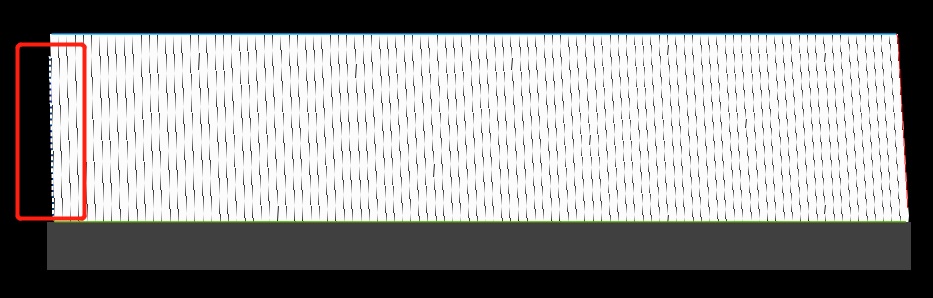

elliptic_axis_xld计算出的Phi分别为[-1.50736, -0.0011843, 0.0213292, 0.0]
左侧边Phi为0.0213292被当作水平轮廓筛选出,这个问题出在哪里,如何能正确区分出上下左右,求大佬指导

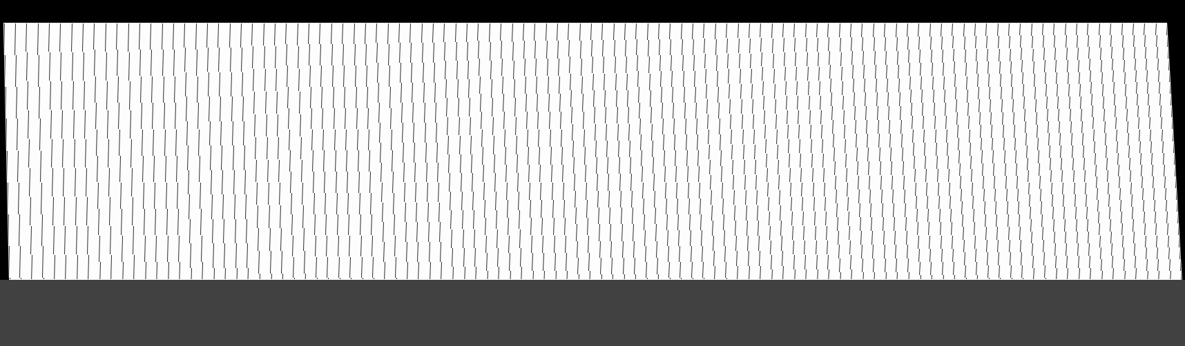

吐个泡泡 发表于 2023-6-8 14:41:16 | 显示全部楼层
  1. read_image (Image1, 'C:/Users/98284/Desktop/1.png')
  2. binary_threshold (Image1, Region, 'max_separability', 'light', UsedThreshold)
  3. fill_up (Region, RegionFillUp)
  4. shape_trans (RegionFillUp, RegionTrans, 'convex')
  5. boundary (RegionTrans, RegionBorder, 'inner')
  6. gen_contour_region_xld (RegionBorder, Contours, 'border')
  7. segment_contours_xld (Contours, ContoursSplit, 'lines_circles', 1, 2, 2)
  8. *左、 上、 右、 下排序
  9. sort_contours_xld (ContoursSplit, SortedContours, 'upper_left', 'true', 'row')
  10. count_obj (SortedContours, Number)
  11. for i := 1 to Number by 1
  12.     select_obj (SortedContours, ObjectSelected, i)
  13.     fit_line_contour_xld (ObjectSelected, 'tukey', -1, 0, 5, 2, RowBegin, ColBegin, RowEnd, ColEnd, Nr, Nc, Dist)
  14.     gen_region_line (RegionLines, RowBegin, ColBegin, RowEnd, ColEnd)
  15. endfor
树lqy 发表于 2023-6-8 16:53:08 | 显示全部楼层
  1. select_shape_xld (UnionContours, SelectedXLD_T, 'row2', 'and', 0, Row)             //*上: Top
  2. select_shape_xld (UnionContours, SelectedXLD_B, 'row1', 'and', Row, Height)        //*下: Bottom
  3. select_shape_xld (UnionContours, SelectedXLD_L, 'column2', 'and', 0, Column)       //*左: Left
  4. select_shape_xld (UnionContours, SelectedXLD_R, 'column1', 'and', Column, Width)
 楼主| freekun139com 发表于 2023-6-9 10:30:58 | 显示全部楼层
select ...
可以呀,对属性理解到位,运用灵活,学习了
  1. row1/column1: upper left corner
  2. row2/column2: lower right corner
 楼主| freekun139com 发表于 2023-6-9 10:33:50 | 显示全部楼层
binary_threshold (Image1, Region, 'max_separabil ...
感谢指导,应该是比较通用的方法,谢谢

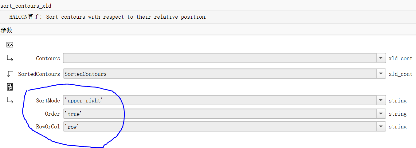

吐个泡泡 发表于 2023-6-14 10:37:20 | 显示全部楼层
更改算子属性
