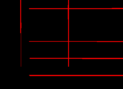

如图 想要将这些线连起来形成封闭的格线,有什么好的方法呢?

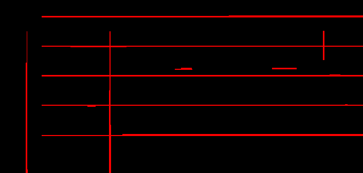

 楼主| scarsss 发表于 2023-6-28 11:06:24 | 显示全部楼层
如图所示
halcon2016 发表于 2023-6-28 11:42:10 | 显示全部楼层
  1. read_image (Image110609gddwb5mb5k5mzh8e, 'C:/Users/Administrator/Desktop/110609gddwb5mb5k5mzh8e.png')
  2. decompose3 (Image110609gddwb5mb5k5mzh8e, Image1, Image2, Image3)
  3. threshold (Image1, Region, 128, 255)
  4. opening_rectangle1 (Region, RegionOpening, 1, 10)
  5. opening_rectangle1 (Region, RegionOpening1, 60, 1)
  6. union2 (RegionOpening, RegionOpening1, RegionUnion)
  7. closing_rectangle1 (RegionUnion, RegionClosing, 1, 30)
  8. closing_rectangle1 (RegionClosing, RegionClosing1, 40, 1)
  9. shape_trans (RegionClosing1, RegionTrans, 'rectangle1')
  10. * gen_contour_region_xld (RegionTrans, Contours, 'border')
  11. erosion_circle (RegionTrans, RegionErosion1, 3.5)
  12. difference (RegionTrans, RegionErosion1, RegionDifference)
  13. union2 (RegionClosing1, RegionDifference, RegionUnion1)
