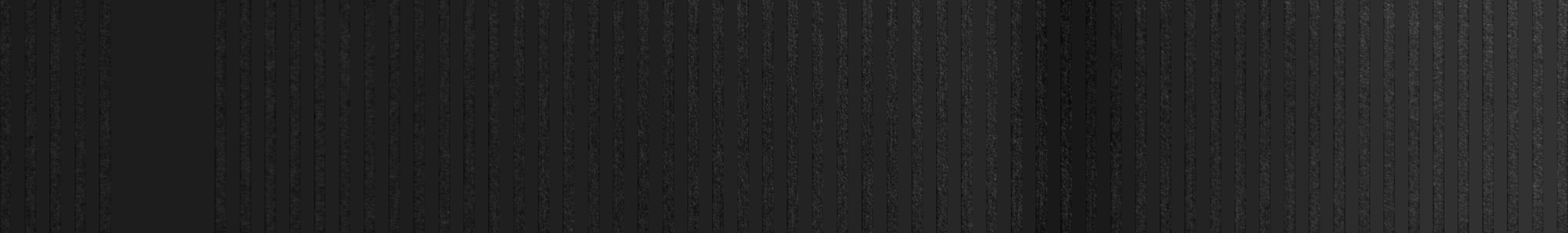

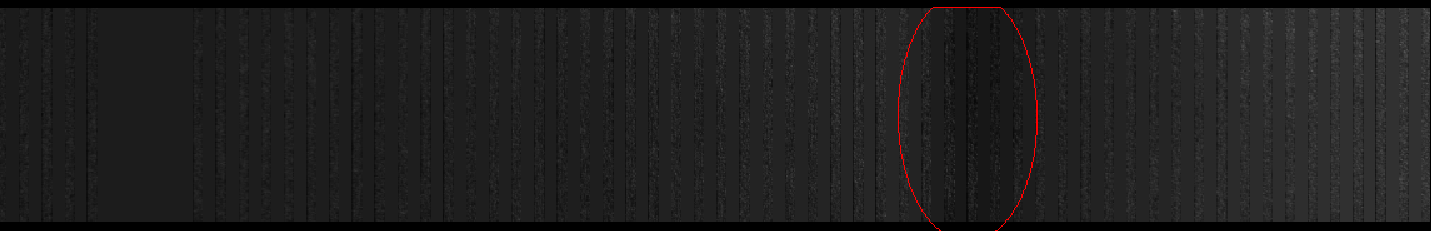

图中被框出的部分为较暗的目标区域,求助筛选思路
由于图像不均匀,且目标区域高为图像高度,小菜已无力
求助大佬指点,不胜感激
筛选较暗的区域
筛选较暗的区域
原图
原图

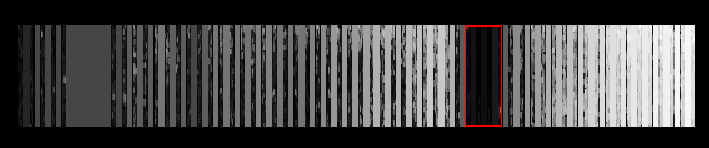

innerone82 发表于 2023-7-31 22:59:15 | 显示全部楼层
  1. equ_histo_image (Image1, ImageEquHisto)
  2. gray_opening_rect (ImageEquHisto, ImageOpening, 21, 5)
  3. threshold (ImageOpening, Region, 0, 30)
  4. fill_up (Region, RegionFillUp)
  5. connection (RegionFillUp, ConnectedRegions)
  6. select_shape_std (ConnectedRegions, SelectedRegions, 'max_area', 70)

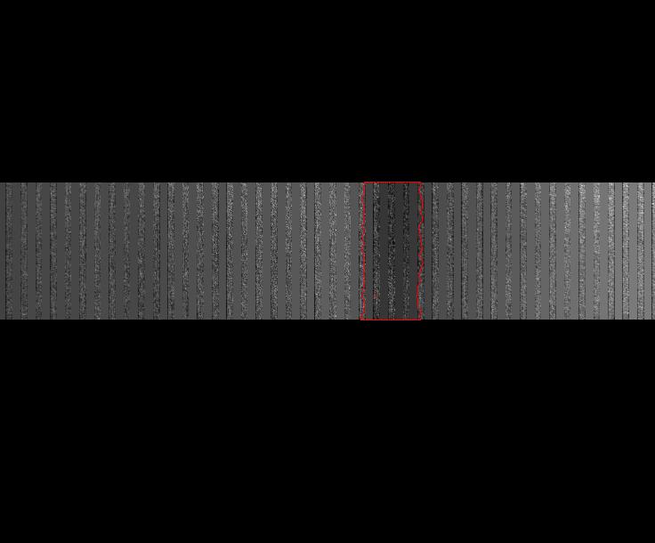

halcon2016 发表于 2023-8-1 08:58:18 | 显示全部楼层
  1. read_image (Image221822kpffm6rh6m6hmmks, 'C:/Users/Administrator/Desktop/221822kpffm6rh6m6hmmks.png')
  2. scale_image_max (Image221822kpffm6rh6m6hmmks, ImageScaleMax)
  3. median_image (ImageScaleMax, ImageMedian, 'circle', 11, 'mirrored')
  4. mean_image (ImageMedian, ImageMean, 399, 299)
  5. dyn_threshold (ImageMedian, ImageMean, RegionDynThresh, 3, 'dark')
  6. connection (RegionDynThresh, ConnectedRegions)
  7. select_shape_std (ConnectedRegions, SelectedRegions, 'max_area', 70)

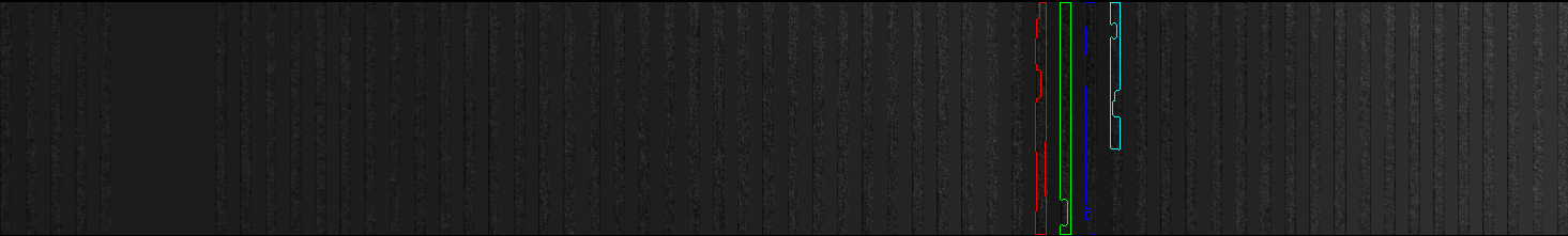

 楼主| freekun139com 发表于 2023-8-1 09:20:32 | 显示全部楼层
  1. *尝试一种方法
  2. gray_opening_shape (ImageResult, ImageOpening, 45, 7, 'rectangle')
  3. gray_closing_shape (ImageOpening, ImageClosing, 3, 3, 'octagon')
  4. mean_image (ImageClosing, ImageSmooth, 3, 3)
  5. mean_image (ImageClosing, ImageSmooth1, 455, 11)
  6. dyn_threshold (ImageSmooth, ImageSmooth1, RegionDynThresh, 7, 'dark')
  7. opening_circle (RegionDynThresh, RegionOpening, 3.5)
  8. closing_circle (RegionOpening, RegionClosing, 3.5)
  9. connection (RegionClosing, ConnectedRegions1)
  10. select_shape (ConnectedRegions1, SelectedRegions2, 'area', 'and', 4000, 999999)
测试结果
测试结果

halcon2016 发表于 2023-8-1 10:11:56 | 显示全部楼层
freekun139com 发表于 2023-8-1 09:40
感谢大佬,
请教一下这里的中值滤波是怎么考虑的,基本上没用过中值滤波
同时如果有多个目标区域如何考虑 ...
如果图像中有很多孤立离散的点,可以考虑中值滤波,多个目标区域最后筛选的时候就不用最大值筛选 ,而是筛选面积符合一定要求的区域
