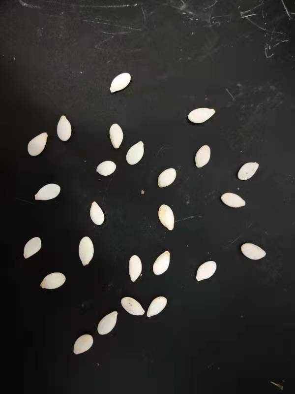

halcon新人,想学好机器视觉,请问如何识别出种子的尖端,也就是出芽点,是求曲率最大的点吗

暗翼小哥 发表于 2023-9-1 08:51:11 | 显示全部楼层
我感觉不太好做,扁长的还行,椭圆的就很难弄出来了,不晓得用深度学习行不行
zjjdsg 发表于 2023-9-1 10:12:20 | 显示全部楼层
哪个算发芽的圈出来看看

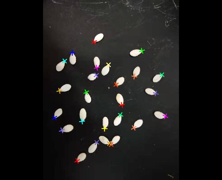

思路仅供参考,除了那个近似圆形的误别有点问题,其它的都能正确识别
  1. read_image (Image205146eayten6lo17nzo7a, 'C:/Users/Administrator/Desktop/205146eayten6lo17nzo7a.jpg')
  2. threshold (Image205146eayten6lo17nzo7a, Region, 160, 255)
  3. connection (Region, ConnectedRegions)
  4. select_shape (ConnectedRegions, SelectedRegions, 'area', 'and', 800, 1500)
  5. dilation_circle (SelectedRegions, RegionDilation, 3.5)
  6. union1 (RegionDilation, RegionUnion)
  7. reduce_domain (Image205146eayten6lo17nzo7a, RegionUnion, ImageReduced)
  8. edges_color_sub_pix (ImageReduced, Edges, 'canny', 1, 20, 40)
  9. select_contours_xld (Edges, SelectedContours, 'contour_length', 50, 20000, -0.5, 0.5)
  10. area_center_xld (SelectedContours, Area1, Row2, Column2, PointOrder)
  11. gen_cross_contour_xld (Cross1, Row2, Column2, 26, 0.785398)
  12. shape_trans_xld (SelectedContours, XLDTrans, 'rectangle2')
  13. count_obj (XLDTrans, Number)
  14. gen_empty_obj (EmptyObject)
  15. for Index := 1 to Number by 1
  16.     select_obj (SelectedContours, ObjectSelected, Index)
  17.     select_obj (XLDTrans, ObjectSelected1, Index)
  18.     gen_region_contour_xld (ObjectSelected, Region1, 'filled')
  19.     smallest_rectangle2_xld (ObjectSelected1, Row, Column, Phi, Length1, Length2)
  20.     gen_rectangle2_contour_xld (Rectangle, Row, Column, Phi, Length1-0.01, Length2+3)
  21.     intersection_contours_xld (ObjectSelected, Rectangle, 'all', Row, Column, IsOverlapping)
  22.     gen_region_points (Region3, Row, Column)
  23.     connection (Region3, ConnectedRegions2)
  24.     area_center (ConnectedRegions2, Area2, Row3, Column3)
  25.     gen_cross_contour_xld (Cross, Row3, Column3, 36, 0.785398)
  26.     gen_circle (Circle, Row3, Column3, [10.5,10.5])
  27.     intersection (Circle, Region1, RegionIntersection)
  28.     area_center (RegionIntersection, Area, Row1, Column1)
  29.     tuple_find (Area, min(Area), Indices)
  30.     gen_cross_contour_xld (Cross2, Row3[Indices], Column3[Indices], 26, Phi)
  31. *     dev_display (Image205146eayten6lo17nzo7a)
  32. *     dev_display (Cross2)
  33.     concat_obj (EmptyObject, Cross2, EmptyObject)
  34. *     stop ()
  35. endfor
  36. dev_display (Image205146eayten6lo17nzo7a)
  37. dev_display (EmptyObject)

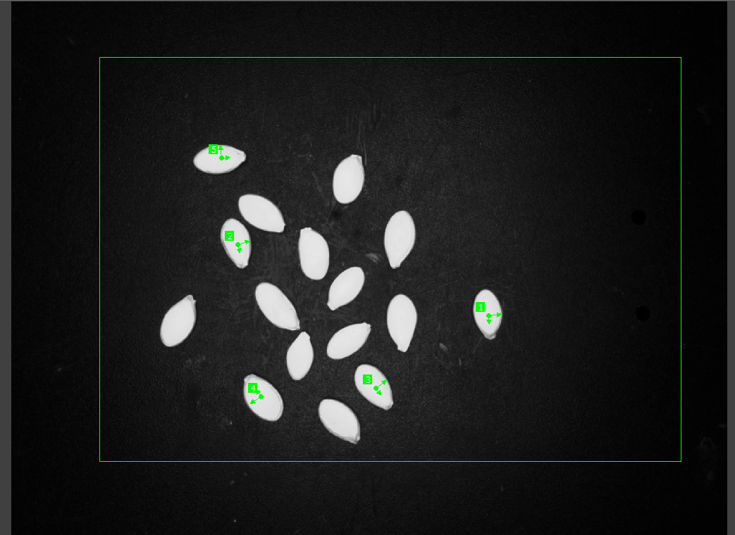

参考halcon官方案例clip

老老常 发表于 2023-9-1 15:46:57 | 显示全部楼层
树lqy 发表于 2023-9-1 15:05
参考halcon官方案例clip
牛皮牛皮,这个方法好
halcon2016 发表于 2023-9-1 15:49:15 | 显示全部楼层
参考halcon官方案例clip
这个方法很不错
duibuqininshur 发表于 2023-9-1 17:11:28 | 显示全部楼层
参考halcon官方案例clip
这个方法好,牛皮牛皮
