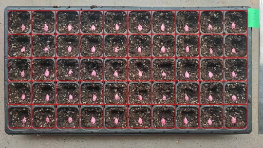

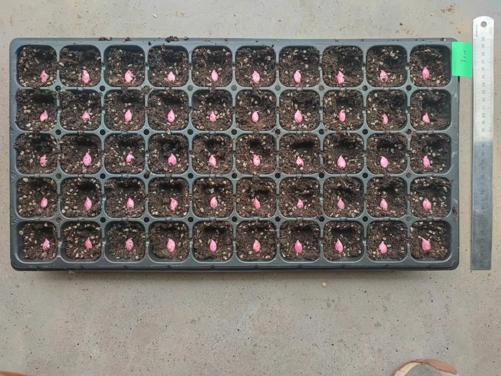

8579a62f029bd683d81c8cd5d80f664.jpg 请问这个怎么划分网格,可以让他一格一格的单独标注出来
Ggg3434 发表于 2023-10-24 08:32:09 | 显示全部楼层
哥们 这之前是不是都帮你单独分离出来了?

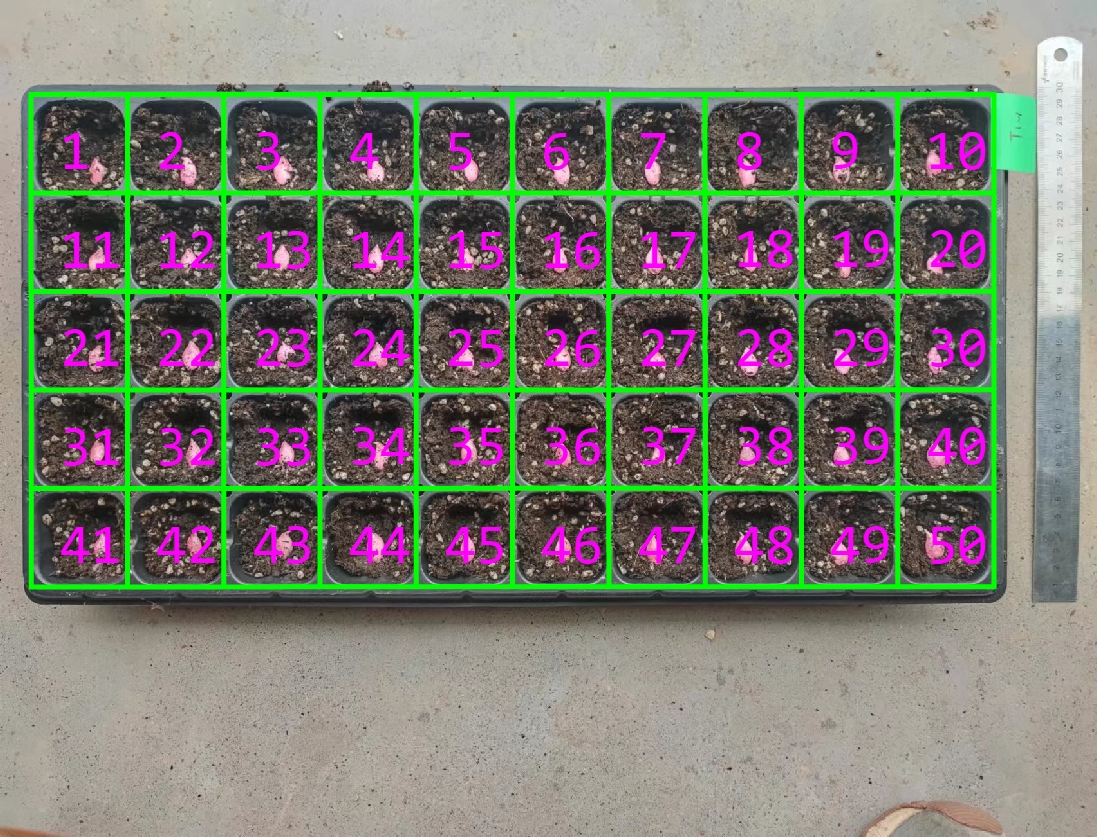

这个样子?
  1. dev_update_off ()
  2. read_image (Image, 'Image.jpg')
  3. **创建种植箱等大小的矩形
  4. lenght:= 1526
  5. width:= 782
  6. gen_rectangle2_contour_xld (Rectangle, 0, 0, 0, lenght/2, width/2)
  7. **创建
  8. create_shape_model_xld (Rectangle, 'auto', -0.39, 0.79, 'auto', 'auto', 'ignore_local_polarity', 5, ModelID)
  9. **查找
  10. find_shape_model (Image, ModelID, -0.39, 0.79, 0.5, 1, 0.5, 'least_squares', 0, 0.9, Row, Column, Angle, Score)
  11. **显示查找到的数据
  12. dev_display_shape_matching_results ( ModelID, 'red', Row, Column, Angle, 1, 1, 0)
  13. **缩进参数
  14. IndentX:=15
  15. IndentY:=15
  16. **分割矩形  看我封装的算子
  17. partition_rectangle2_contour_xld (Contours , Row, Column, Angle,lenght/2-IndentY, width/2-IndentX, 5,10, rows, cols, phis, len1s, len2s)
  18. area_center_xld (Contours, Area, Rows, Columns, PointOrder)
  19. **等差数列
  20. tuple_gen_sequence (1, |Area|, 1, Index)
  21. **显示
  22. dev_display (Image)
  23. dev_set_line_width (5)
  24. dev_set_color ('green')
  25. dev_display (Contours )
  26. disp_message_ext (200000, Index, 'image', Rows-40, Columns-30, 'magenta', 'false', 50)
 楼主| 想学好视觉 发表于 2023-10-24 14:04:44 | 显示全部楼层
