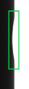

求助大佬,这种边缘有明显的缺失一块的部分(红色框区域)算缺陷,而上边弯弯曲曲的部分(绿色框区域)不算缺陷,应当如何处理,原图太大,附上链接:https://pan.baidu.com/s/17YSmXPCFq7teVxGwWQKwng?pwd=1234

  1. read_image (Image320231113171459, 'C:/Users/Barbie/Desktop/3_20231113171459.bmp')
  2. rgb1_to_gray (Image320231113171459, GrayImage)
  3. threshold (GrayImage, Region, 0, 190)
  4. connection (Region, ConnectedRegions)
  5. select_shape_std (ConnectedRegions, SelectedRegions, 'max_area', 70)
  6. closing_rectangle1 (SelectedRegions, RegionClosing, 50, 50)
  7. difference (RegionClosing, SelectedRegions, RegionDifference)
  8. opening_circle (RegionDifference, RegionOpening, 5)
  9. connection (RegionOpening, ConnectedRegions1)
  10. shape_trans (ConnectedRegions1,RegionTrans,'outer_circle')
  11. dev_set_draw ('margin')
  12. dev_display (Image320231113171459)
  13. dev_display (RegionTrans)

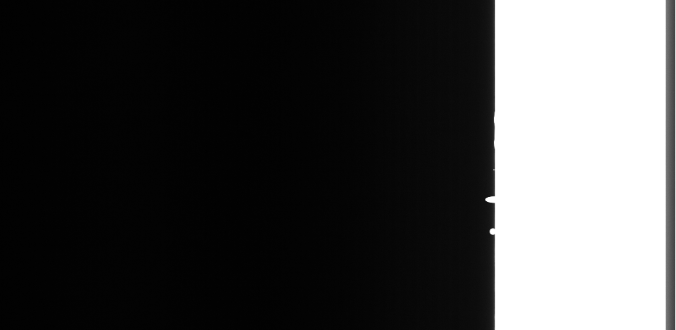

 楼主| dh2022 发表于 2023-11-17 13:43:56 | 显示全部楼层
Barbie 发表于 2023-11-17 14:23:11 | 显示全部楼层
其实你 先拟合直线 在计算点到线距离 找连续超出像素的异常点也行的
