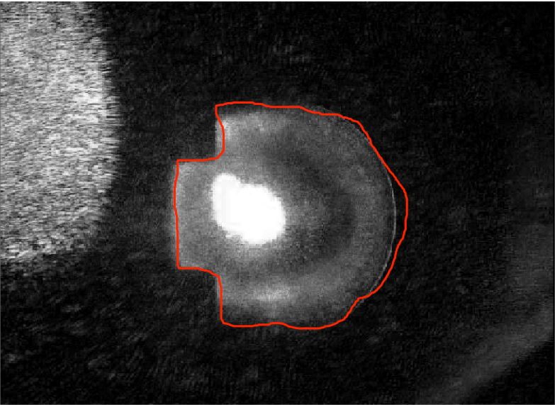

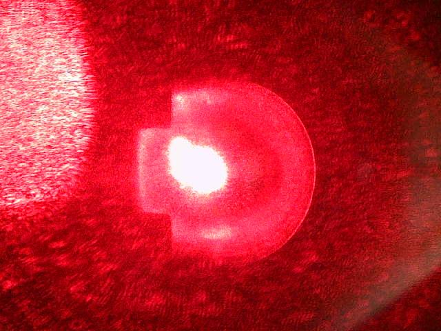

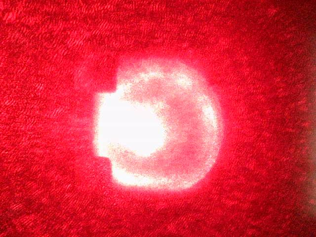

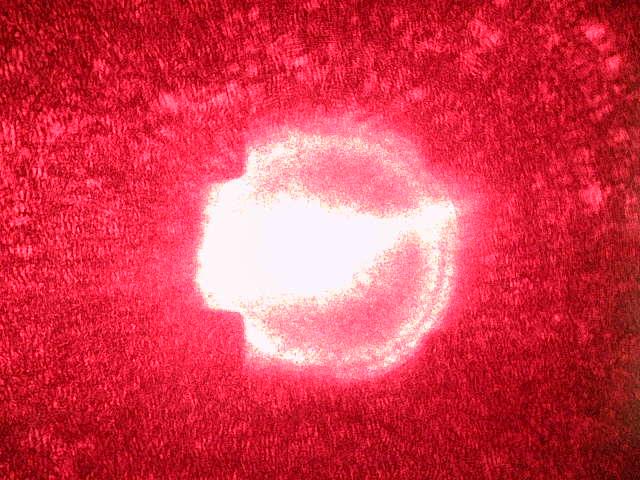

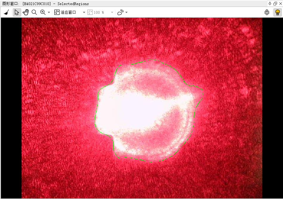

情况是这样的,激光固定位置,打到反射面,判断反射面的状态。如下图。
我获取反射面的区域时候,一直处理不好。我是这样操作的:
  1. decompose3 (Image, Red, Green,Blue)
  2. threshold (Blue, Regions, 102, 255)
  3. connection (Regions, ConnectedRegions)
  4. select_shape_std (ConnectedRegions, SelectedRegions1, 'max_area', 70)
  5. opening_circle (SelectedRegions1, RegionClosing, 1.8)
  6. fill_up (RegionClosing, RegionFillUp)
不能通用,而且取得区域也不是很理想。
各位大佬有啥好法子

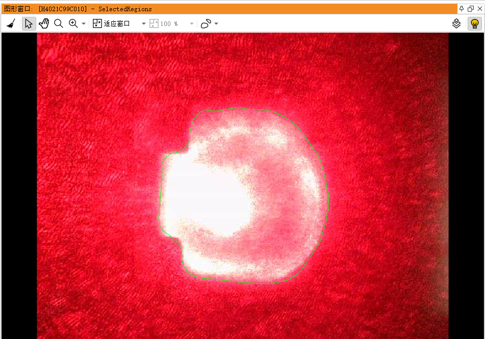

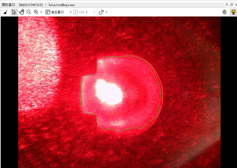

halcon2016 发表于 2024-1-25 13:45:42 | 显示全部楼层
  1. list_files ('C:/Users/Administrator/Desktop/新建文件夹', ['files','follow_links','recursive'], ImageFiles)
  2. tuple_regexp_select (ImageFiles, ['\\.(tif|tiff|gif|bmp|jpg|jpeg|jp2|png|pcx|pgm|ppm|pbm|xwd|ima|hobj)$','ignore_case'], ImageFiles)
  3. for Index := 0 to |ImageFiles| - 1 by 1
  4.     read_image (Image, ImageFiles[Index])
  5.     * Image Acquisition 01: Do something
  6.     decompose3 (Image, Image1, Image2, Image3)
  7.     trans_from_rgb (Image1, Image2, Image3, ImageResult1, ImageResult2, ImageResult3, 'hsv')
  8.     median_rect (Image3, ImageMedian, 35, 35)
  9.     emphasize (ImageMedian, ImageEmphasize, 77, 77, 11)
  10.     threshold (ImageEmphasize, Region, 120, 255)
  11.     fill_up (Region, RegionFillUp)
  12.     connection (RegionFillUp, ConnectedRegions)
  13.     select_shape_std (ConnectedRegions, SelectedRegions, 'max_area', 70)
  14.     dev_display (Image2)
  15.     dev_display (SelectedRegions)
  16.     stop ()
  17. endfor
能提个大概区域
