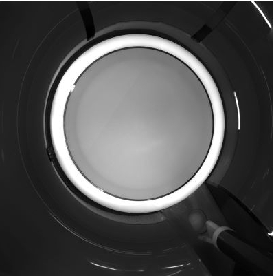

求助,低对比度裂纹缺陷检测。
Heath 发表于 2024-4-7 13:49:49 | 显示全部楼层 |阅读模式
求助,低对比度裂纹缺陷检测。
图片25MB,附件限制1000KB。

halcon2016 发表于 2024-4-7 15:06:31 | 显示全部楼层
裂纹在哪里??缺陷在哪里??
 楼主| Heath 发表于 2024-4-7 15:40:05 | 显示全部楼层
裂纹在哪里??缺陷在哪里??
原图缺陷坐标,2990,1543 至
 楼主| Heath 发表于 2024-4-7 15:41:16 | 显示全部楼层
原图缺陷坐标,2990,1543 至
1160,2775 ,缺陷在左上部分
halcon2016 发表于 2024-4-7 17:02:43 | 显示全部楼层
  1. read_image (B, 'C:/Users/Administrator/Desktop/00-14-57.953 A035149#03.tif')
  2. illuminate (B, BB, 101, 101, 1.1)
  3. threshold (B, Region, 100, 200)
  4. connection (Region, ConnectedRegions)
  5. select_shape_std (ConnectedRegions, SelectedRegions, 'max_area', 70)
  6. fill_up (SelectedRegions, RegionFillUp)
  7. opening_circle (RegionFillUp, RegionOpening, 163.5)
  8. erosion_circle (RegionOpening, RegionErosion, 163.5)
  9. emphasize (BB, ImageEmphasize, 177, 177, 15)
  10. smooth_image (ImageEmphasize, ImageSmooth, 'gauss',5.)
  11. reduce_domain (ImageSmooth, RegionErosion, ImageReduced)
  12. edges_sub_pix (ImageReduced, Edges, 'canny', 12, 15, 25)
  13. union_adjacent_contours_xld (Edges, UnionContours, 10, 1, 'attr_keep')
  14. length_xld (UnionContours, Length)
  15. select_contours_xld (UnionContours, SelectedContours, 'contour_length',max(Length), max(Length), -0.5, 0.5)
