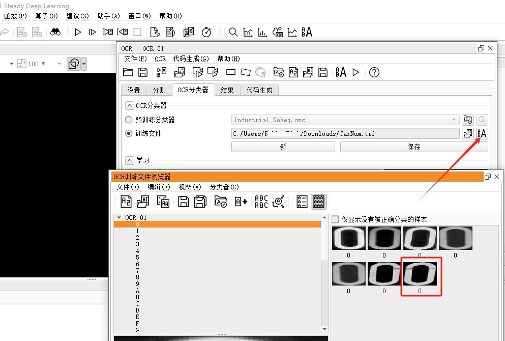

*.omc是最终训练的库无法删除,如果是*.trf文件目前只能通过hdevelop中的助手->创建新的OCR里面的菜单进行删除后再训练库即可

Criss 发表于 2024-5-17 21:15:34 | 显示全部楼层
  1. read_ocr_trainf (Characters, 'D:/1.trf', CharacterNames)
  2. RemoveIndex:=0 //删除的索引号,图像是从1开始,元组是从0开始
  3. remove_obj (Characters, ObjectsReduced, RemoveIndex + 1)
  4. tuple_remove (CharacterNames, RemoveIndex, Reduced)
  5. write_ocr_trainf_image (ObjectsReduced, Reduced, 'D:/1.trf')
根据索引删除trf文件对应图像和字符
