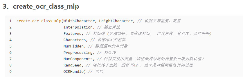

create_ocr_class_mlp算子第一二两参数,识别字符宽高度如果是一个字符串(0123456789)它们的高度宽度不统一,这里的宽高度取最大值吗?
halcon2016
发表于 2024-5-21 10:21:26
a character to be classified is transformed to a standard size, which is determined by WidthCharacter and HeightCharacter
是字符需要缩放到的大小,并不是字符实际大小
