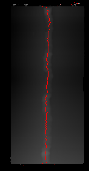

 楼主| 求帮助halcon 发表于 2024-7-8 19:12:16 | 显示全部楼层
这图是筛选区域后的图,算每行的灰度最大值然后连起来是这个样子,但太费时了

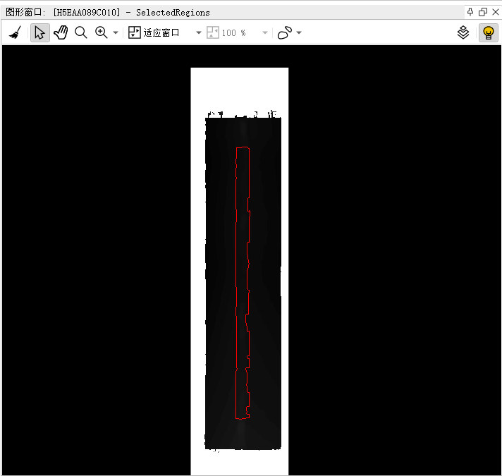

halcon2016 发表于 2024-7-9 09:06:06 | 显示全部楼层
  1. read_image (Image173106mh3g5kvfl7p3wg57, 'C:/Users/Administrator/Desktop/173106mh3g5kvfl7p3wg57.png')
  2. scale_image_max (Image173106mh3g5kvfl7p3wg57, ImageScaleMax)
  3. emphasize (ImageScaleMax, ImageEmphasize, 99, 99, 17)
  4. mean_image (ImageEmphasize, ImageMean, 99, 19)
  5. dyn_threshold (ImageEmphasize, ImageMean, RegionDynThresh, 3, 'light')
  6. threshold (Image173106mh3g5kvfl7p3wg57, Region, 0, 50)
  7. fill_up (Region, RegionFillUp)
  8. intersection (RegionDynThresh, RegionFillUp, RegionIntersection)
  9. connection (RegionIntersection, ConnectedRegions)
  10. select_shape_std (ConnectedRegions, SelectedRegions, 'max_area', 70)

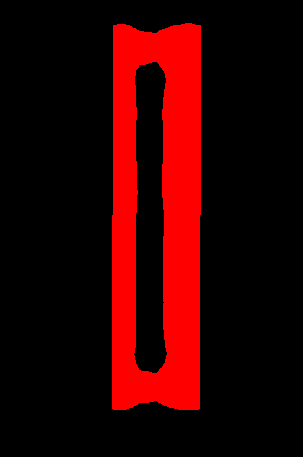

luliang971212 发表于 2024-7-9 14:04:41 | 显示全部楼层
兄弟这样可以吗
