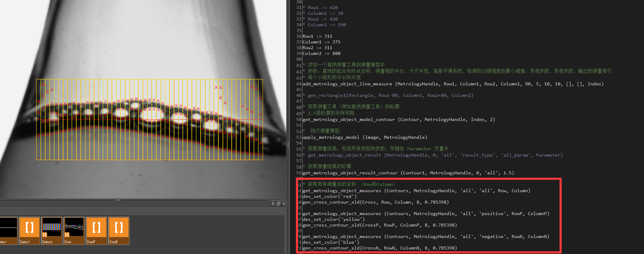

请问各位大佬,当get_metrology_object_measures设置参数为'all'时候Row和Column不为空,
  1. read_image(Image,'C:/Users/Lenovo/Desktop/papers/one shot learning/RegAD/111111111.png')
  2. *获取图像大小
  3. get_image_size (Image, Width, Height)
  4. rgb1_to_gray(Image, GrayImage)
  5. *打开一个新窗口
  6. * dev_open_window_fit_image (Image, 0, 0, Width/4, Width/4, WindowID)
  7. *创建测量句柄
  8. create_metrology_model (MetrologyHandle)
  9. *测量直线的起始点坐标
  10. Row1 := 195
  11. Column1 := 121
  12. Row2 := 195
  13. Column2 := 620
  14. * 添加一个直线测量工具到测量模型中
  15. add_metrology_object_line_measure (MetrologyHandle, Row1, Column1, Row2, Column2, 80, 5, 10, 10, [], [], Index)
  16. * 获取测量工具(例如直线测量工具)的轮廓
  17. get_metrology_object_model_contour (Contour, MetrologyHandle, Index, 2)
  18. *  执行测量模型
  19. apply_metrology_model (GrayImage, MetrologyHandle)
  20. * 获取测量结果的轮廓
  21. get_metrology_object_result_contour (Contour1, MetrologyHandle, 0, 'all', 1.5)
  22. * 获取所有测量点的坐标 (Row和Column)
  23. get_metrology_object_measures (Contours, MetrologyHandle, 'all', 'all', Row, Column)
  24. dev_set_color('red')
  25. gen_cross_contour_xld(Cross, Row, Column, 8, 0.785398)
复制代码
但是改成'positive'和'negative'之后Row和Column都为空,请问这个是为啥咧
  1. get_metrology_object_measures (Contours, MetrologyHandle, 'all', 'positive', RowP, ColumnP)
  2. dev_set_color('yellow')
  3. gen_cross_contour_xld(CrossP, RowP, ColumnP, 8, 0.785398)
复制代码
  1. get_metrology_object_measures (Contours, MetrologyHandle, 'all', 'negative', RowN, ColumnN)
  2. dev_set_color('blue')
  3. gen_cross_contour_xld(CrossN, RowN, ColumnN, 8, 0.785398)
复制代码

halcon2016 发表于 2024-8-28 13:35:37 | 显示全部楼层
apply_metrology_model (GrayImage, MetrologyHandle)前面加上set_metrology_object_param (MetrologyHandle, 'all', 'measure_transition', 'uniform')就可以了

好咧,加上就确实可以了,有学到了一个没见过的算子,谢谢啦  发表于 2024-8-28 14:11
halcon2016 发表于 2024-8-28 13:38:53 | 显示全部楼层
理论上讲你那样获取也是没问题的,要么是正的,要么是负的,总有一个有结果,但实际结果确实有点奇怪,感觉是有点bug
点评
好好,感谢大佬,我也是才学,就是觉得逻辑上这样应该行得通的,却不行,算子啥的不会的太多,确实不知道缺了啥,还是慢慢积累着。谢谢大佬  发表于 2024-8-28 14:13
