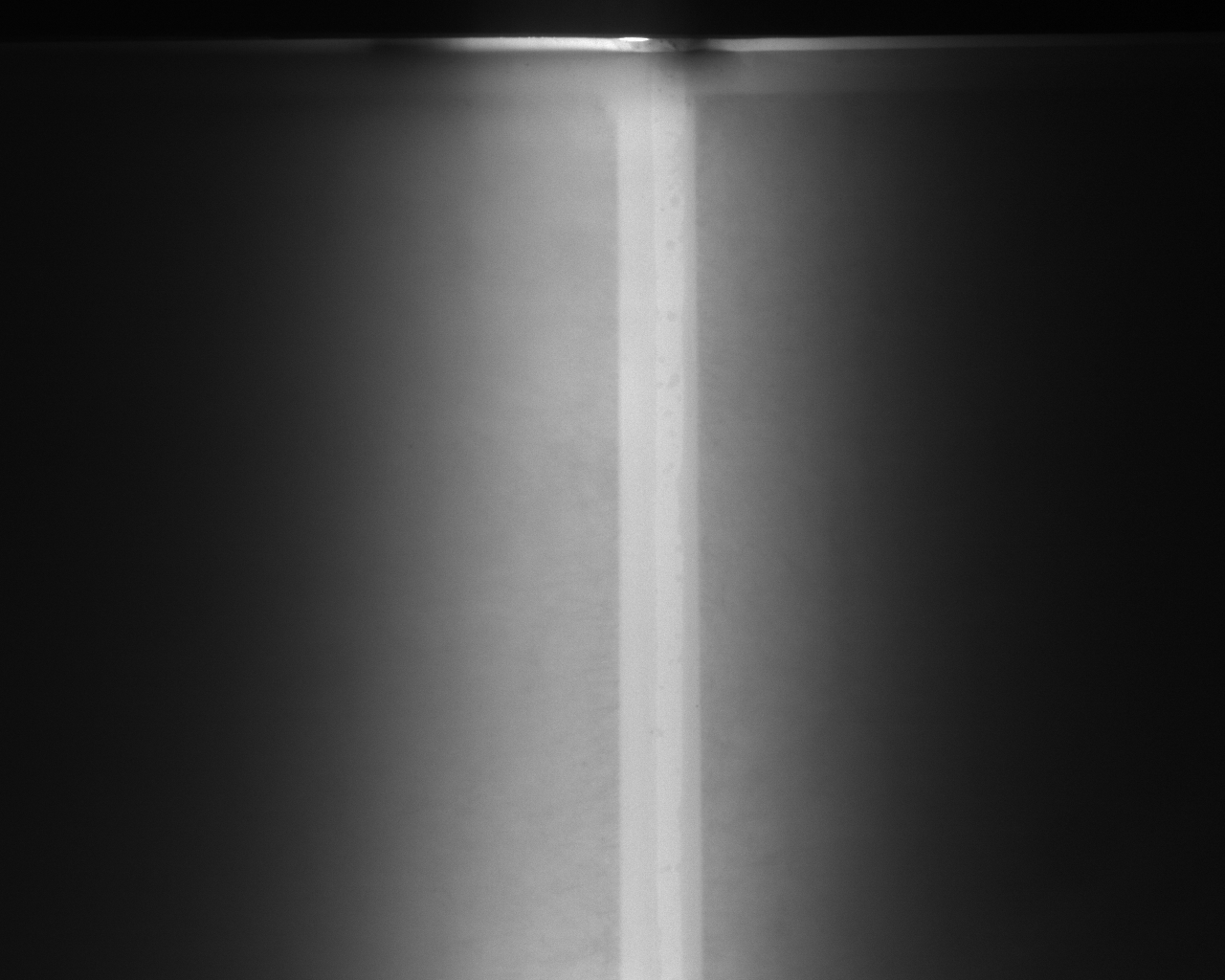

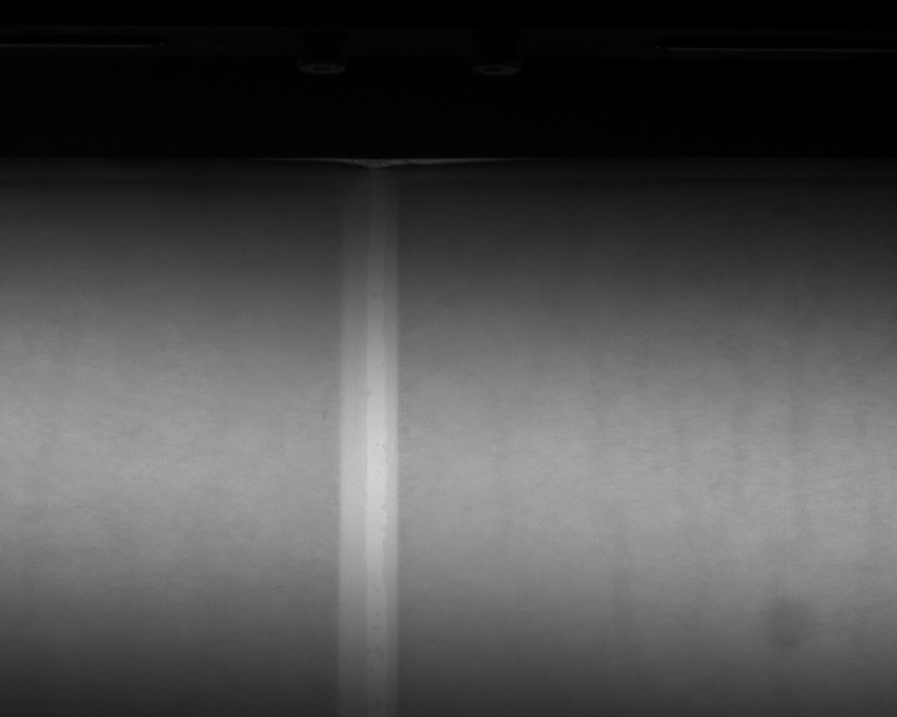

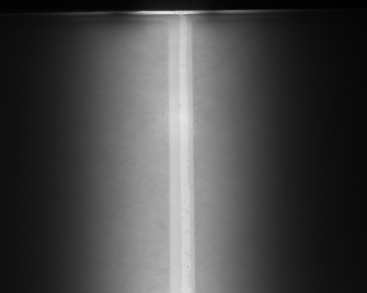

把打光图片的边界拟合出来
Laocui1992 发表于 2024-10-11 14:36:14 | 显示全部楼层 |阅读模式
悬赏300视觉币
把打光图片的边界拟合出来,将拟合出来的效果进行划线显示

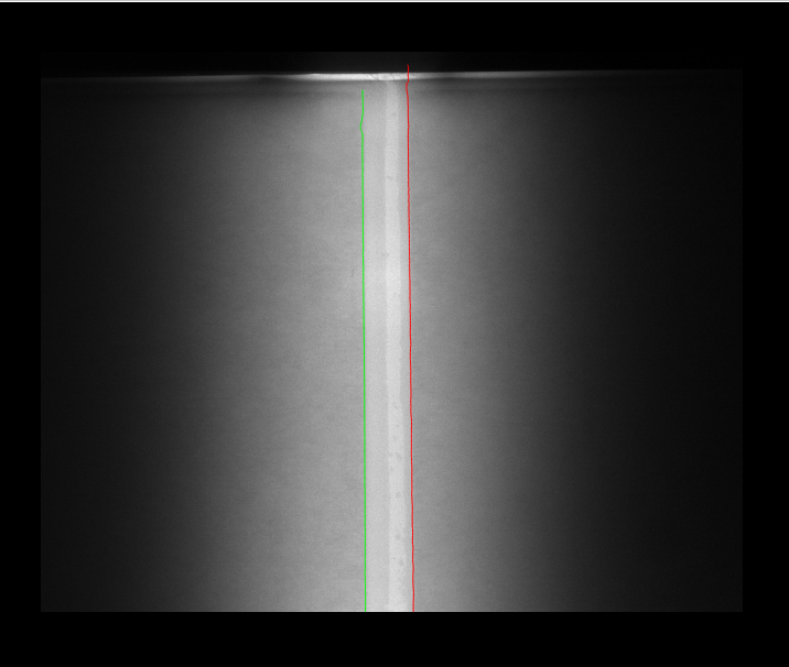

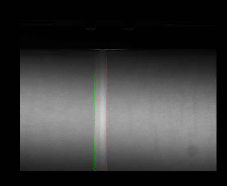

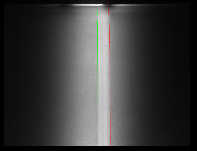

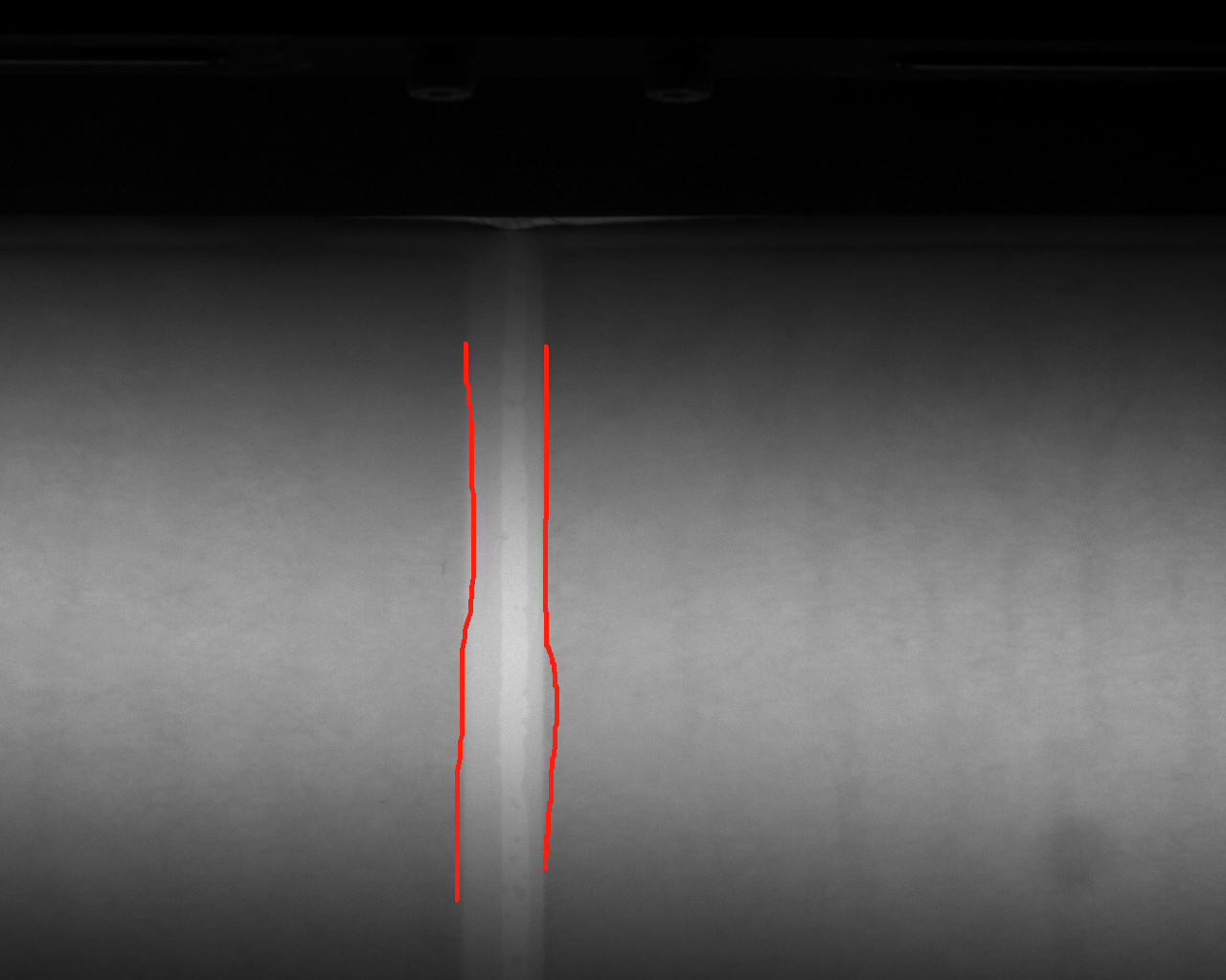

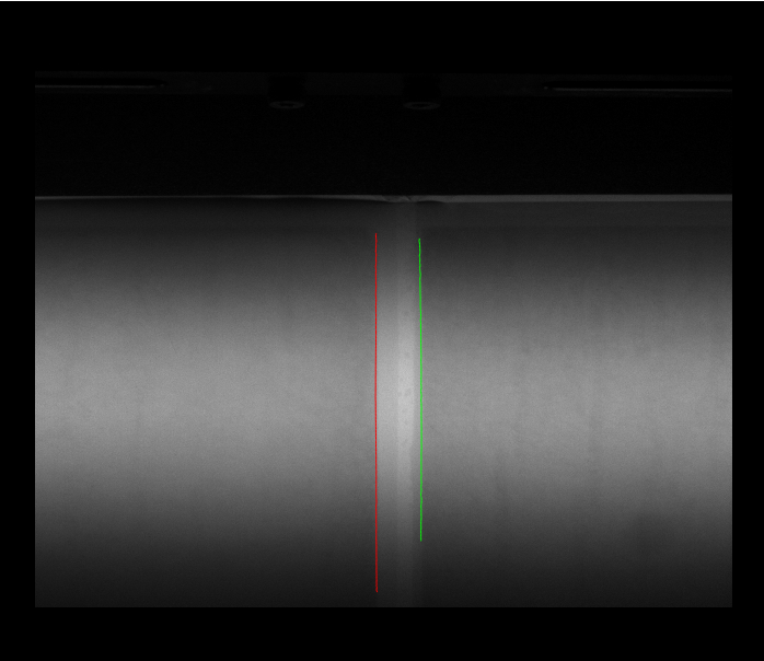

halcon2016 发表于 2024-10-11 14:36:15 | 显示全部楼层
  1. list_files ('C:/Users/Administrator/Desktop/新建文件夹', ['files','follow_links','recursive'], ImageFiles)
  2. tuple_regexp_select (ImageFiles, ['\\.(tif|tiff|gif|bmp|jpg|jpeg|jp2|png|pcx|pgm|ppm|pbm|xwd|ima|hobj)$','ignore_case'], ImageFiles)
  3. for Index := 0 to |ImageFiles| - 1 by 1
  4.     read_image (Image, ImageFiles[Index])
  5.     * Image Acquisition 02: Do something
  6.     mean_image (Image, ImageMean, 10, 199)
  7.     emphasize (ImageMean, ImageEmphasize, 77, 77, 15)
  8.     edges_sub_pix (ImageEmphasize, Edges, 'canny', 2, 30, 60)
  9.     union_adjacent_contours_xld (Edges, UnionContours, 2, 1, 'attr_keep')
  10.     length_xld (UnionContours, Length)
  11.     tuple_sort_index (Length, Indices)
  12.     tuple_inverse (Indices, Inverted)
  13.     select_obj (UnionContours, ObjectSelected, Inverted[0:1]+1)
  14.     dev_display (Image)
  15.     dev_display (ObjectSelected)
  16.     stop ()
