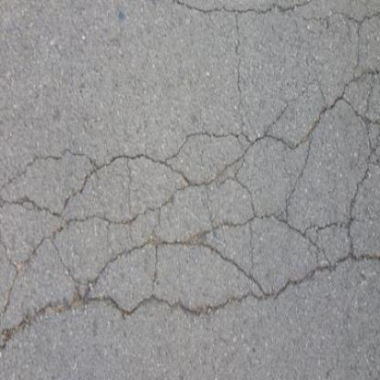

求助大神帮忙识别这个裂痕
ww619531882 发表于 2024-11-28 10:19:25 | 显示全部楼层 |阅读模式
谁能帮我识别出这个列横,希望大神给出代码。

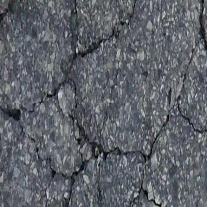

giraffe灬 发表于 2024-12-8 21:58:39 | 显示全部楼层
read_image (Image7, 'C:/Users/z126w/Downloads/7.jpg')
mean_image (Image7, ImageMean, 20, 20)
dyn_threshold (Image7, ImageMean, RegionDynThresh, 8, 'dark')
connection (RegionDynThresh, ConnectedRegions)
select_shape (ConnectedRegions, SelectedRegions, ['contlength'], 'or', [100], [99999])
union1 (SelectedRegions, RegionUnion)
read_image (Image1336, 'C:/Users/z126w/Downloads/1336.jpg')
threshold (Image1336, Region, 0, 55)

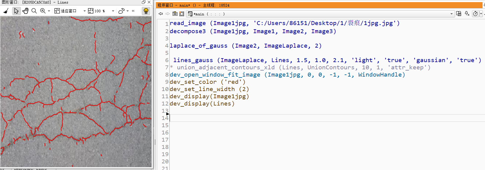

自爆炸主宰 发表于 2024-12-10 16:40:47 | 显示全部楼层
C:\Users\86151\Desktop\halcon案例\1
自爆炸主宰 发表于 2024-12-10 16:45:04 | 显示全部楼层
自爆炸主宰 发表于 2024-12-10 16:46:11 | 显示全部楼层
