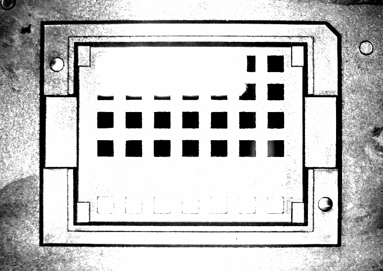

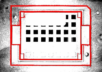

想提取出中载具的轮廓,但是不知道怎么过滤四个角的黑色干扰,求助大佬

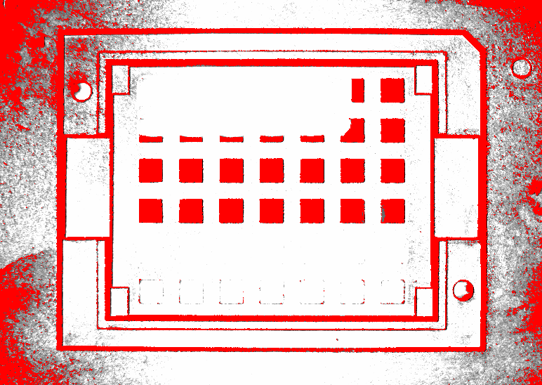

建議先看看 Halcon 自帶範例
examples\solution_guide\basics\surface_scratch.hdev
  1. read_image (Image103520gadtadvm86iciva3, 'C:/Users/genel/OneDrive/桌面/103520gadtadvm86iciva3.png')
  2. mean_image(Image103520gadtadvm86iciva3, ImageMean, 31, 31)
  3. dyn_threshold(Image103520gadtadvm86iciva3, ImageMean, RegionDynThresh, 9, 'dark')
  4. opening_circle(RegionDynThresh, RegionOpening, 1.5)
  5. connection(RegionOpening, ConnectedRegions)
  6. select_shape(ConnectedRegions, SelectedRegions, 'width', 'and', 560, 650)
