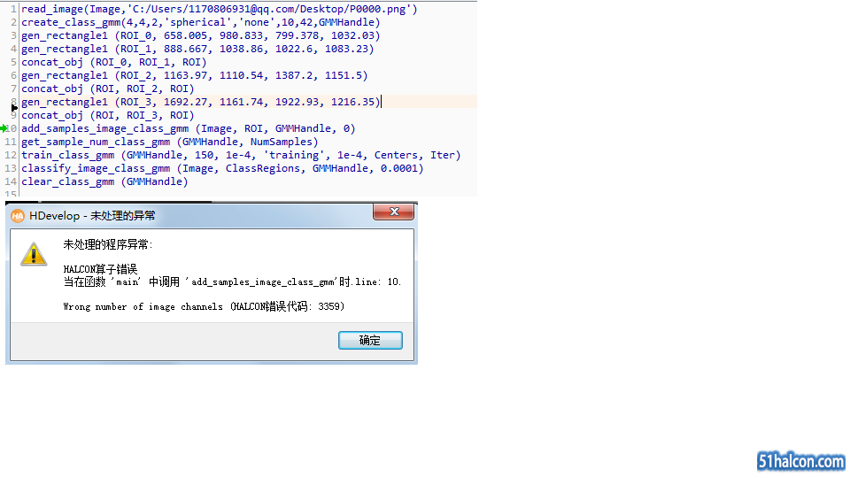

halcon错误代码:wrong number of image channel
请问在算子add_samples_image_class_gmm (Image, ROI, GMMHandle, 0)中Image该如何设置不会报这种错误

The Image must have a number of channels equal to NumDim, as specified with create_class_gmm,你的Image图像通道问题:lol
