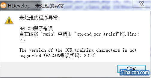

- #define H_ERR_OCR_TRF 8313 /* The version of the OCR training characters
- is not supported */
