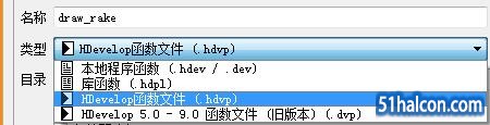

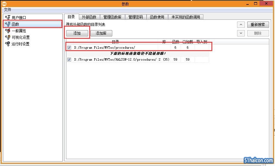

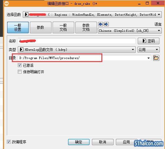

    if your procedure is local,ohters can's access it,you can save it as outter function file like *.hdvp,by the way,attatch it to function dir params. QQ截图20180221183544.jpg
    then,you can access it on others function

    edit your sub function interface and save to disk,not your *.hdev file
